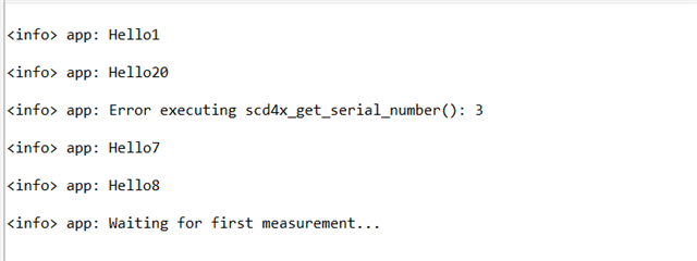

BLE_APP_UART does not work when add twi_sensor
Hello everyone, currently I am writing a program to read the SCD41(I2C) sensor and then use BLE to transmit information. With a separate program in twi_sensor, I see that the sensor is working, then I add the necessary files and edit a few files like sdk_config, add nrf_twi.c. Finally, when building, everything says completed.
However, I discovered a problem: the advertising part doesn't seem to work (the light on the board doesn't flash and when using nrf connect on the phone, it doesn't find device name to connect). Then I tried using the ble_app_uart file (without the sensor), I added a line of code printf("Hello") and I realized the same situation, the advertising part also didn't work although all reported a successful build.
Hope everyone can help me?
    Do you also flash and program the MCU ?
    Do you have some log output that you can share ?
    Did you erase the MCU before programming it again ?

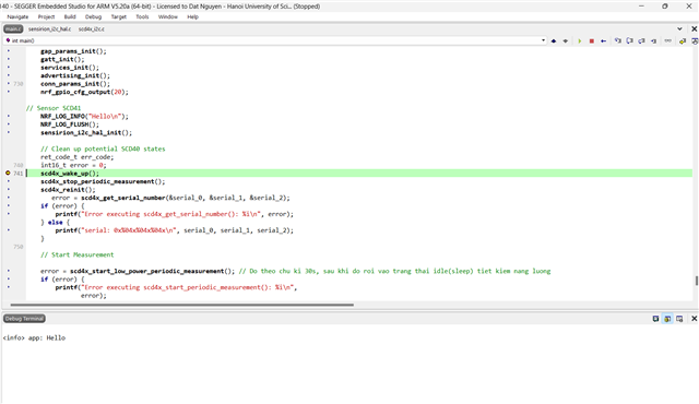

    // Sensor SCD41
        printf("Hello\n");
        sensirion_i2c_hal_init();
        // Clean up potential SCD40 states
        ret_code_t err_code;
        int16_t error = 0;
        scd4x_wake_up();
        scd4x_stop_periodic_measurement();
        scd4x_reinit();

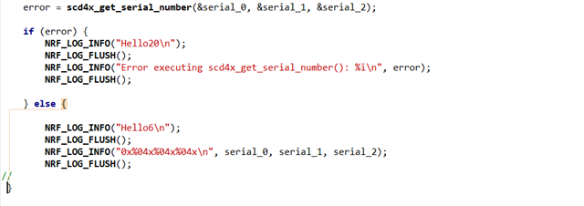

           error = scd4x_get_serial_number(&serial_0, &serial_1, &serial_2);
        if (error) {
            printf("Error executing scd4x_get_serial_number(): %i\n", error);
        } else {
            printf("serial: 0x%04x%04x%04x\n", serial_0, serial_1, serial_2);
        // Start Measurement
        error = scd4x_start_low_power_periodic_measurement(); // Do theo chu ki 30s, sau khi do roi vao trang thai idle(sleep) ti?t ki?m nang lu?ng
        if (error) {
            printf("Error executing scd4x_start_periodic_measurement(): %i\n",
                   error);
        printf("Waiting for first measurement... (5 sec)\n");
        // Start execution.
        printf("\r\nUART started.\r\n");
        advertising_start();

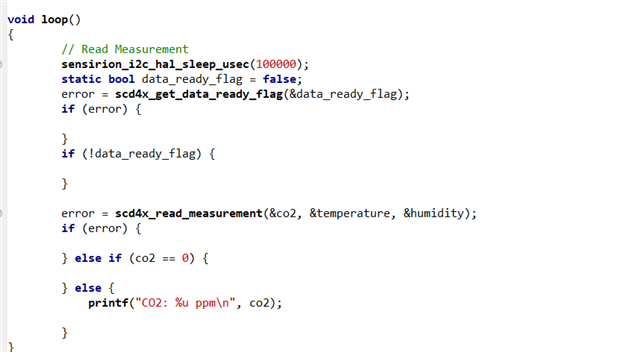

          for (;;) {
            // Read Measurement
            sensirion_i2c_hal_sleep_usec(100000);
            bool data_ready_flag = false;
            error = scd4x_get_data_ready_flag(&data_ready_flag);
            if (error) {
                printf("Error executing scd4x_get_data_ready_flag(): %i\n", error);
                continue;
            if (!data_ready_flag) {
                continue;
            error = scd4x_read_measurement(&co2, &temperature, &humidity);
            if (error) {
            } else if (co2 == 0) {
            } else {
                printf("CO2: %u ppm\n", co2);
        // Enter main loop.
        for (;;)
            idle_state_handle();
    Hi JONATHAN, this is my main.c. I have fixed the communication error (when using nrf connect I can connect), but there is one problem: when I debug, I don't see the sensor parameters (like when I code separately for twi_sensor ).

        uint32_t err_code = ble_advertising_start(&m_advertising, BLE_ADV_MODE_FAST);
        bool erase_bonds;
        // Initialize.
        uart_init();
        log_init();
        timers_init();
        power_management_init();
        ble_stack_init();
        gap_params_init();
        gatt_init();
        services_init();
        advertising_init();
        conn_params_init();
    // Sensor SCD41
        printf("Hello\n");
        int16_t error = 0;
        scd4x_wake_up();
        scd4x_reinit();
        if (error) {
        } else {
        if (error) {
                   error);
        // Start execution.
          for (;;) {
            // Read Measurement
            if (error) {
                continue;
                continue;
            if (error) {
            } else {
        // Enter main loop.
        for (;;)
