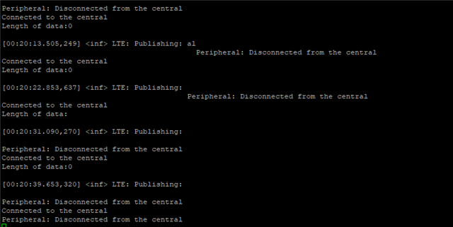

BLE disconnects when LTE publish data in Fanstel module PKBLG840F
I am developing an application where the nrf52840dk acts as peripheral device and sends data to nrf52840 of fanstel module. The fanstel nrf52840 acts as an central device. The data is relayed via UART to fanstel nrf9160.
A note: I am using fanstel module BLG840F which has nRF52840 and nRF9160.
I have used BLE central and peripheral example from nRF52840 sdk with no modification in the central and slight modification for constantly sending data in peripheral.
For nrf9160, I have used mqtt example from nRF sdk connect with slight modification where in I added workqueue for UART. The workqueue then post the received data via mqtt.
Currently what is happening is when the Fanstel's nRF9160 is publishing the data, the BLE connection is lost between nrf52840dk and Fanstel nrf52840. After the data is published it tries to connect again. This keeps on happening whenever Fanstel's nRF9160 publishes data via mqtt.
I am not sure what is happening and would greatly appreciate help.
