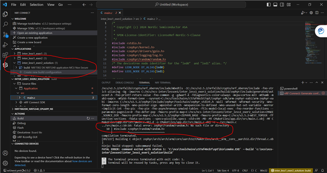

Issue for less1_exer2 of DevAcademy nRF Connect SDK Intermediate
Hi Support Team
The less1_exer2 of DevAcademy nRF Connect SDK Intermediate has below issue when I build it. Many thanks.
  • Hi Tom.Fu,
    It is a bit difficult to tell the true reason for the build error, since I can only see a small part of it. However, this is what I found when I tried to build the solution to exercise 2:
    I got a warning about the path length:
    CMake Warning in C:/ncs/v2.6.0/nrf/subsys/nrf_security/src/CMakeLists.txt:
      The object file directory
        C:/ncs/v2.6.0/nrf/samples/devacademy/ncs-inter/lesson1/inter_less1_exer2_solution/build/tfm/secure_fw/partitions/crypto/mbedcrypto/nrf_security_src/CMakeFiles/crypto_service_mbedcrypto.dir/./
      has 191 characters.  The maximum full path to an object file is 250
      characters (see CMAKE_OBJECT_PATH_MAX).  Object file
        C_/ncs/v2.6.0/nrf/ext/oberon/psa/core/library/psa_crypto_slot_management.o
      cannot be safely placed under this directory.  The build may not work
      correctly.
    To fix that error I renamed the application directory from inter_less1_exer2_solution to inter_less1_exer2_sol. This change resulted in a successful build.
    Are you able to build successfully if you shorten the application name?
    If not, please share the full build log by including it in a reply with Insert -> Code. Then we can help you to find a solution for your build error.
