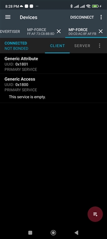

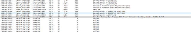

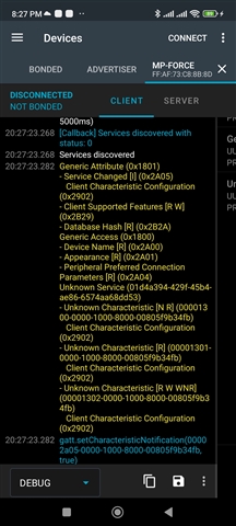

With nRF52DK the custom services characteristics are shown but if I upload the code to the ebyte e73-tbb, the custom service and characteristics are not shown. The same shows with nrf connect app in PC via the nrf52840_dongle. The build and code are the same. The ebyte e73-tbb has already predefined template for build in Zephyr. Im using the nrfconnect plugin in vscode. Do I need to adjust something? I have used this module multiple times and code should have same result. This is the first time I encountered it. TIA

    Click on the 3 dots in the upper right corner, and click "Refresh services", are you able to discover the services?
  • Hello! and thanks for reply. I have tried that. It still says empty list.
  • That's strange. Do you have any log output(e.g. from the UART) from the device? Any warnings or errors in the log?
  • Yeah very strange. Now there is none currently.  Based on my searches it shows it might be lack of RAM, or need to adjust address because of the additional characteristic? but those searches all shows from old SDK, not zephyr.
    Before I turned off DIS and other parameters like CCC, CUD cause I suspect the characteristic might be too many for slow phones, this one shows.
    failed to allocate new mpu region 255
