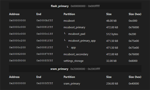

    Yes, it seems like the settings (where bond information are stored) is overwritten. I need to rebond after FOTA.
    However, the memory report shows a reserved settings_storage area in the upper part of flash (0x000F8000 - 0x000FFFFF).
    But is it still overwritten at DFU?
    The memory report:
    What I am doing to get the behaviour:
    - Build the modified lbs example
    - Erase flash on PCA10056
    - Flash it with the modified lbs example
    - Check debug output
    - Connect with the lbs example and access the Button characteristics, so pairing is triggered
    - Pair and bond
    - Do a little modification for the lbs example and copy it the tablet
    - Do FOTA DFU with nRF Connect from tablet
    - Verify that the modification is installed on PCA10056 (debug output)
    If I now reset the board, the firmware is reverted back to old version, or if I try to access a characteristics, pairing is triggered (then bonding must be bonding deleted)

    But that did not change anything. Memory report stays the same, bonding information is still overwritten, and firmware still reverts.
    How do I prevent the overwrite of bonding information?
