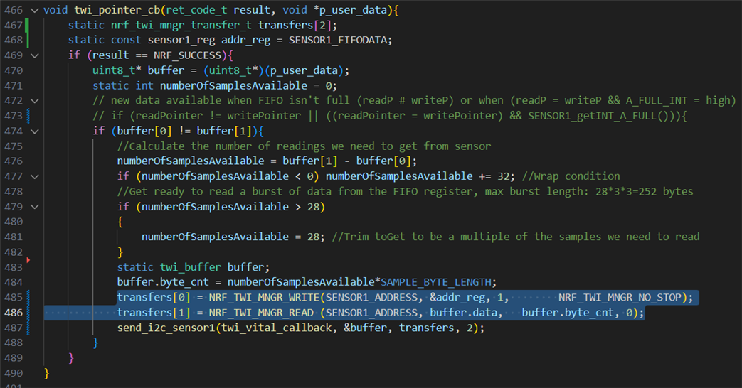

  • Thank you Ovrebekk for your help. It helps me solve the issue for most functions, except in this place I needs to calculate the number of bytes to read from TWI on the fly. So I cannot use static const for the transfers array. How should I deal with this case?
  • Hi
    You don't need to use both static and const, just static is sufficient.
    Just be aware that you won't be able to declare the variable and assign the data values on the same line, since the declaration of a static value only happens once and can not contain dynamic data.
    Instead you can declare the static variable at the top of the function, without assigning a value to it, and assign values to it later on where the variable is to be used.
    Best regards
    Torbjørn
  • Hi Ovrebekk,
    I tried your suggestion but the compiler doesn't allow it.
  • Hi
    That makes sense, those macros will only work when initializing a struct, not when assigning values to it. Either you can create some const structs that you later copy into the transfers array, or you can simply assign the fields of the struct directly.
    The nrf_twi_mngr_transfer_t struct only consists of the following elements, which you are free to assign directly without using the macros:
