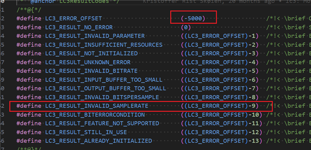

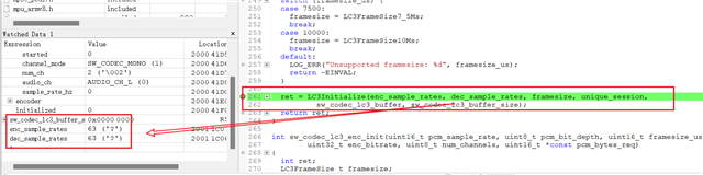

I traced the code using ozone, the error occured by calling "LC3Initialize" function, which is provided by library.
The -5009 errror code means INVALID_SAMPLERATE.
But from the ozone debug, the enc_sample_rates and dec_sample_rates transfered to LC3Initialize were all 63.
Could you please help me to resolve this issue.
