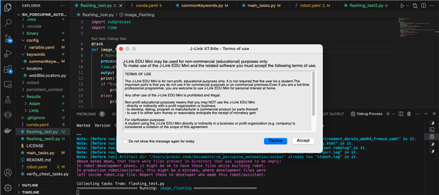

I am creating one script in Python using nrfjprog that will flash the .hex file in the device but for that, I have to accept the terms of use manually so is there any way I can bypass that?

can you please explain in detail, I have tried with the pynrfjprog library but when we connect the target device using (probe.connect_to_emu_with_snr(801044079,2000)), the JLink Terms of Use pop-up is displayed and I have to accept the agreement manually
You cannot script your way around that. For commercial use, you need another debugger. And for educational use, I am afraid you just have to live with it. But you must contact Segger regarding licensing, as the debugger is their product.
