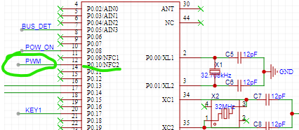

Hi,Nordic Tech Support friends:
       I try to use the pin "P0.10/NFC2" to ooutput a PWM wave,but only output  zero.
The schematic is as follows:
The PWM signal should appear on both sides of R07,but not appear any PWM signal ,only zero.
I try to move away the MOS-FET "HL20N04",The problem still cannot be solved.
I have  measured the connectivity between the chip and the resistor ,it's good.
I try to give a PULLUP signal to the resistor R07  from the MCU‘s pin “P0.10/NFC2” ,and about a  3V voltage appears on the  both sides of R07.
To sum up, the pin “P0.10/NFC2”  can give PULLUP signal,and can not give a PWM wave.
It was so strange,I am expecting your prompt reply.
