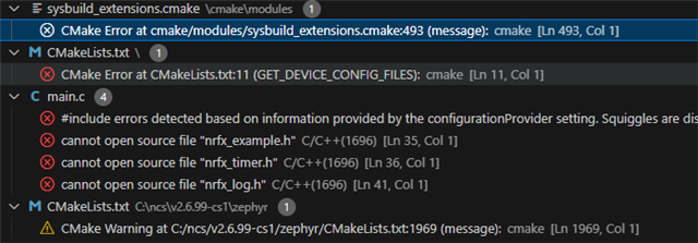

i tried to start a new project with timer example to understand how the timer functions works, but both of the available project won't compile.
i got this error :
i'm little bit confused with the SDK version number. the SDK version that i downloaded from VS code was 2.6.99-cs1 and in the internet there are other SDK version available for download, like the latest 17.1 : https://www.nordicsemi.com/Products/Development-software/nRF5-SDK/Download
Does the VS code has it own SDK ?
and the code for example for timer uses the SDK17.1 or  2.6.99 ?
All i want is to run a basic timer on the vs code.

    I would recommend starting reading about Zephyr and timers here. Since you are new to our SDK I would strongly encourage you to go through our course NCS Fundamentals to get you familiar with our SDK and Zephyr. We also have additional courses on DevAcademy do help you get started.
    I tested the timer sample and it built out of the box for me. Which board did you select under build configuration? In general you can ignore the problem tab in VScode as it does not provide any meaningful information when using NCS.
