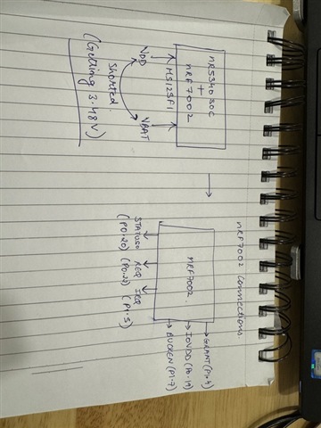

I have been trying to implement the wifi scan or wifi provisioning code on a module (MS12SF1) which is a combine wifi + ble module

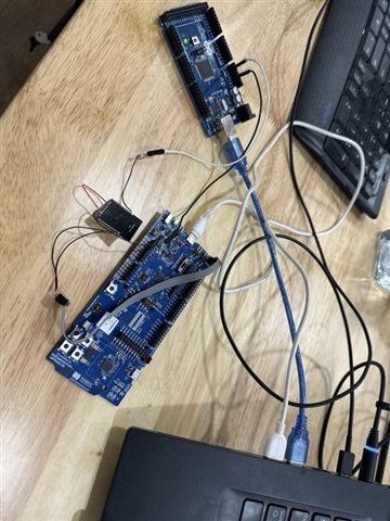

The setup looks like the image shown below
I am giving power to the module through Arduino as it can give 3v3, the module currently is receiving 3.48V and the SWDIO and SWDCLK pins are connected with the nrf5340DK through the JLink cable.
So currently after configuring everything, I am constantly getting the below error that network is not getting initialised.

The pin configurations present in the overlay file, I have done as per the datasheet only.
In the image attached above the Vdd and Vbat of the module is shorted as per the datasheet.
I am struggling with this issue for very long, don't know what to do next
