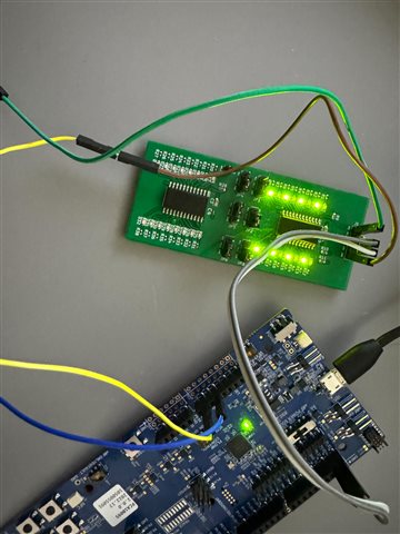

Hello!
I'm following the NRF Academy Fundamentals course and I am facing an issue with I2C devices.
I have an STM32 board with HAL code (Non-Zephyr) and I am able to interface the PCF8574 IC successfully.
This sensor board has 10k pull-up resistors attached to SDC and SCL. The pull-up voltage is 5V.
When I tried to run the solution provided for Exercise6-1, I had two Issues:
  • Bus fault: I solved it by switching NCS from v2.6.0 to v2.5.3
  • I2C error: [2024-05-09 17:49:25] [00:04:59.580,963] <err> i2c_nrfx_twim: Error 0x0BAE0001 occurred for message 0
    [2024-05-09 17:49:25] Failed to write to I2C device address 40 at Reg. aabb, -5

  • Hi Runar,
    Thanks for response!
    I found out what was wrong with my code. The address is supposed to be 0x20 and not 0x40, as it a 7-bit address. ST HAL API expects an 8-bit left shifted value, which confused me.
    Here is an alternating pattern for:
    uint16_t data = 0xAA55;
    It works with the same DT binding I initially provided with the default arduino pins (P1.03 and P1.02).
    &i2c1 {
        mysensor: mysensor@20{
          compatible = "i2c-device";
          status = "okay";
          reg = < 0x20 >;
    Thanks again for pointing out the issue, it helped in figuring out the solution.
