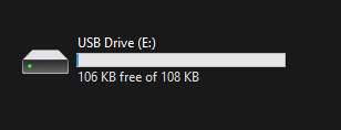

I'm working on a device that needs a USB storage connection capability. I have put the "mass" sample into my application, and it works as expected except for one thing -- I can't seem to change the displayed name of the mounted drive.
I'm working in SDK v2.5.0 / nRF52840 / Windows 11 Host.
The nRF USB port connection connects as "USB Drive (E:)" and I can use my computer to format the drive to whatever name I want (e.g. USB_CfgTool (E:)). I want to be able to set this name programmatically.

  • Hi Edvin
    Here's what I've got for now.
    The device is showing up as "USB Drive (E:)"

    We're still a USB drive.
    Switching to a MacBook ----
    That same device connects as "NO NAME"

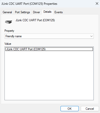

  • Hello Finn,
    Can you open device manager in windows, and check the device under the details view:
    (Just an old DK as an example).
    Are your customizations present there?

  • Hi -- the DevKit shows up in Two places. One for the JLink UART Port, one for the nRF USB Connection.
    On the USB Connection
    and on JLINK UART
    Neither place shows my customizations.
    I'm having the device show up as "Auli_Desktop" -- and I've even tried uninstalling the drivers for both the JLink device and the USB connection from the device manager page to no effect.
