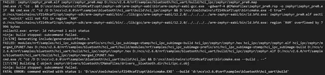

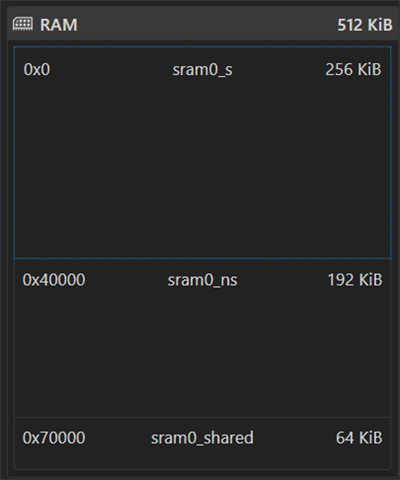

The shared SRAM for network CPU is 64K and I can't increase it's size by modified dts file.
This causes RAM overflow problems when building the hci_ipc child image.
I want to decrease the size of sram0_ns so that I can increase the size of sram0_shared.
