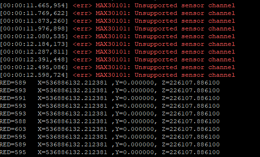

I want to test two sensors, MPU6050 and MAX30101, in a Xiao nRF52840; however, I am struggling to obtain data from the MPU6050 sensor. I noticed that even if I enabled MPU6050 in the prj.conf, it tells me that it's disabled in build. If my understanding is correct then since it depends on DT_HAS_INVENSENSE_MPU6050_ENABLED, the problem lies in my xiao_ble.overlay not properly configured to add the mpu6050? I first tried the sample MPU6050 (I only modified the xiao_ble.overlay, replacing i2c0 to i2c1) but it didn't work so I tried running it with the MAX30101. In this trial, MAX30101 works fine but not MPU6050. What may I have overlooked?
For reference here is the snippet of the prj.conf file with yellow squiggles, the output in PuTTY, the whole xiao_ble.overlay, prj.conf and main.c codes. I'm using SDK v2.5.2.
In this output, the MAX30101 works fine because the values of RED are responsive but not XYZ.

Here is my xiao_ble.overlay:
&i2c1 {
    maxim_max30101: max30101@57 {
		compatible = "maxim,max30101";
        reg = <0x57>;
        status = "okay";
	invensense_mpu6050: mpu6050@68 {
		compatible = "invensense,mpu6050";
		reg = <0x68>;
		status = "okay";
Here is my prj.conf:

Here is my main.c
#include <zephyr/kernel.h>
#include <zephyr/device.h>
#include <zephyr/drivers/sensor.h>
#include <stdio.h>
	struct sensor_value red;
	struct sensor_value accel[3];
	const struct device *const dev = DEVICE_DT_GET_ANY(maxim_max30101);
	const struct device *const mpu = DEVICE_DT_GET_ANY(invensense_mpu6050);
	if (dev == NULL) {
		printf("Could not get max30101 device\n");
		return 0;
	if (!device_is_ready(dev)) {
		printf("max30101 device %s is not ready\n", dev->name);
		return 0;
	if (mpu == NULL) {
		printf("Could not get mpu6050 device\n");
		return 0;
	if (!device_is_ready(mpu)) {
		printf("mpu6050 device %s is not ready\n", mpu->name);
		return 0;
	k_sleep(K_MSEC(20));
	while (1) {
		sensor_sample_fetch(dev);
		sensor_channel_get(dev, SENSOR_CHAN_RED, &red);
		k_sleep(K_MSEC(50));
		sensor_sample_fetch(mpu);
		sensor_channel_get(dev, SENSOR_CHAN_ACCEL_XYZ, accel);
		/* Print data*/
		printf("RED=%d   ", red.val1);
		printf("X=%f ,Y=%f, Z=%f\n", sensor_value_to_double(&accel[0]), sensor_value_to_double(&accel[1]), sensor_value_to_double(&accel[2]));
	return 0;
