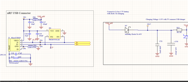

yes,we have logging enabled
main()
Check that the data lines are connected properly.
That is the error code when D+ or D- gets to the "device detected" state but no actuall communication happens at all - usually because some of the basics don't work.
Thanks for the reply Turbo J,
Is it related with impedance matching, we don't do that,
Schematic and track :
Any how fixing it ?
Any how fixing it ?
Hi
Could you provide the full schematic and layout files?
Then we can do a proper review, and see if the design looks OK.
If you don't want to provide your design files in a public case then just let me know, and I can make the case private. Alternatively you can also open a new private ticket.

Hi Ovrebekk,
Thanks for the reply,
For full schematic and layout files, we prefer to be in private case.
We will open a private new private ticket.
It's for USB 2.0, so we don't think impedance match is needed.
