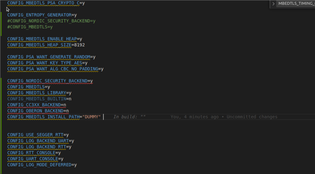

  • I have done these configuration in prj.conf file.
    I was referring "devzone.nordicsemi.com/.../how-to-use-latest-mbed-tls-2-26-0-with-nrf-connect-sdk-v1-5-0-on-thingy-91" link to add mbedtls functionality in my AES-CBC example code.
    But I am getting the run time error :
    Please tell me what is the reason of failure, ASAP
  • The red lines likely are because of Override Kconfig Warnings. I recommend that you look into why your configurations are overidden.
