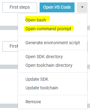

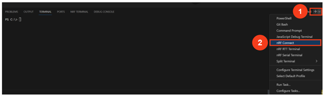

    VS Code integration has no longer a specific nRFConnect Terminal instead tells to you default terminal which is not capable of using "'west". However the second method with the toolchain manager works.
    Build calls needs to be the following in this case - documentation is wrong:
    west build -b nrf52840dongle_nrf52840 zephyr/samples/basic/blinky
    nrfutil pkg generate --hw-version 52 --sd-req=0x00 --application build/zephyr/zephyr.hex --application-version 1 blinky.zip
    nrfutil dfu usb-serial -pkg blinky.zip -p COM7
    Nevertheless:
    Now my green LED is blinking which seems to be fine.
    Many thanks for the help. We may close this issue.
