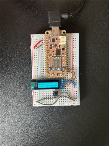

I am having issues getting the LVGL library working with my nRF9160 Feather. I am using SDK version 2.5.0.
I have narrowed it down to the call to: `lv_task_handler()` not returning. I cannot figure out why.
I am using a 128 x 32 SSD1306 board from Amazon.
Can anyone see anything obvious that I am missing?

I get output, but it is garbage as shown in the picture below. My while() loop does not seem to execute unless I comment out lv_task_handler on line 27 in main.c. I assume lv_task_handler is needed to properly process the screen updates.
I've attached a zip folder containing the project if helpful.
