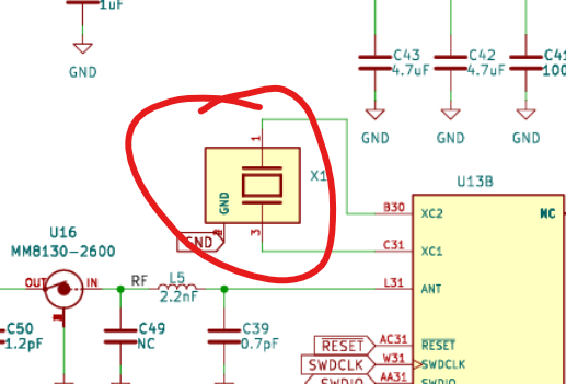

Nrf5340 custom board is not working
Hi All,
I have design my customer board but after production nothing looks to work. i can program  the board through the Nordic board by using debug out. even a simple blinky app is not working i have tried also to send an Ecco through uart and nothing seems to work ,  please attached is my schematic
