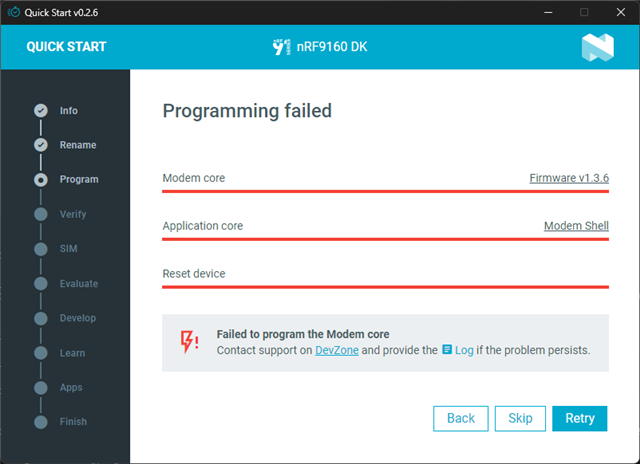

I started fesh on a new laptop, installed nrf Connect for desktop. I used VS Code to install the the latest nrf toolchain and sdk, verison 2.6.1, as they recommend that using Vs code is the preferred method. I then installed the quickstart app, version 0.2.6, inside nrf connect for desktop and tried to flash a sample. Flashing was unsuccessful and with error as seen in the attached images. I also tried flashing a sample using the nrf extension in VS code and got a similar error.
It seems that the J-Link programmer is not detected. I have also tried using the programmer app version 4.3.0 but also no success. See attached log file.
I hope to hear from you soon.

2024-05-14T17:52:27.760Z DEBUG Selected device: nRF9160 DK
2024-05-14T17:52:27.772Z DEBUG Changed step: info
2024-05-14T17:52:56.537Z DEBUG Changed step: rename
2024-05-14T17:52:59.402Z DEBUG Changed step: program
2024-05-14T17:53:23.051Z ERROR [jlink] [NRFJPROG][Worker][000960055660] Cannot call connect_to_emu_without_snr when there is no emulator connected.
2024-05-14T17:53:23.051Z ERROR [jlink] [NRFJPROG][Client][000960055660] Encountered error -13: Command connect_to_emu_with_snr executed for 15 milliseconds with result -13
2024-05-14T18:06:46.969Z ERROR [jlink] [NRFJPROG][Client][000960055660] Encountered error -13: Command connect_to_emu_with_snr executed for 15 milliseconds with result -13
2024-05-14T18:06:46.984Z ERROR [jlink] [NRFJPROG][Worker][000960055660] Cannot call connect_to_emu_without_snr when there is no emulator connected.
