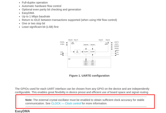

currently I'm facing an issue with the power consumption of my pcb. The idle power consumption is at about 20 µA. After initialising the UART it goes up to over 1 mA. If I uninitialise the UART again, the power consumption stays at about 280 µA which is much higher than before. At the moment of the test both pins from the UART were disconnected.
I'm using SDK5 17.1.0 and the following code snippets to (un-)initialise the UART:

Is there anything I'm missing when deactivating the UART? How can I go back to my idle power consumption?
