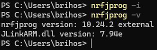

If I open a terminal, JLink is not seeing the target:

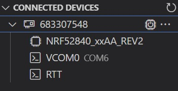

I tried another laptop and here everything is better.  I can build and flash the target.  In connected devices, I see the target:
And in the terminal, JLink is seeing the target:
Version of nrfjprog is identical between these two systems.

    From there I was able to follow the rest of the instructions to update the driver.  And, having done that, when I connect the dev board the BULK interface warning entry has gone, and I am able to see the target appear in "Connected Devices" in VSCode.
