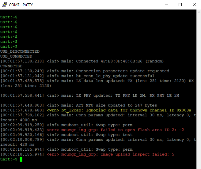

When performing OTA through Bluetooth, I encountered the following issue:
Firmware built in the same build can be successfully updated via OTA using the nRF Connect App on an iPhone (limited to firmware from the same build). However, if firmware from a different build is used, the following error message appears on UART:
 `<err> mcumgr_img_grp: Failed to open flash area ID 2: -2`
` <err> mcumgr_img_grp: Image upload inspect failed: 5`
How can I update the firmware in different built through BLE with the edge device using OTA ?
I am using nrf5340 + ncs2.4.2
    Could you share the whole log here? Please use the insert tab to paste the whole log.
    Please explain what you mean by different builds here. Do you mean different configurations for the same application, or are you trying to build the same application on different hardware? Sorry, I didn't understand this very well.
    By seeing the snippet of the log you shared, it looks like the application is failing to open the mcuboot_secondary slot. Are you using an external flash here? I also recommend checking the partition manager file to see that you have properly configured the mcuboot_primary and secondary slots.

  • Hi Abhijith,
    This is the whole log below
    [00:01:57.130,218] <inf> main: Connected 4F:E8:0F:48:6B:E6 (random)
    CONNECTED
    [00:01:57.130,249] <inf> main: Connection parameters update requested
    [00:01:57.131,042] <inf> main: bt_conn_le_phy_update successful
    [00:01:57.439,575] <inf> main: LE data len updated: TX (len: 251 time: 2120) RX (len: 251 time: 2120)
    [00:01:57.558,441] <inf> main: LE PHY updated: TX PHY LE 2M, RX PHY LE 2M
    [00:01:57.648,803] <inf> main: ATT MTU size updated to 247 bytes
    [00:01:57.678,680] <wrn> bt_l2cap: Ignoring data for unknown channel ID 0x003a
    [00:01:57.799,102] <inf> main: Conn params updated: interval 30 ms, latency 0, timeout: 4000 ms
    [00:02:09.919,250] <inf> mcuboot_util: Swap type: perm
    [00:02:09.919,433] <err> mcumgr_img_grp: Failed to open flash area ID 2: -2
    [00:02:09.920,166] <inf> mcuboot_util: Swap type: test
    [00:02:10.008,789] <inf> main: Conn params updated: interval 30 ms, latency 0, timeout: 420 ms
    [00:02:10.185,974] <inf> mcuboot_util: Swap type: perm
    [00:02:10.185,974] <err> mcumgr_img_grp: Image upload inspect failed: 5
    The different build means same configuration with same prj.conf and nrf5340dk_nrf5340_cpuapp.overlay, hardware and application, but only different build time. For example: build_1 and build_2.
