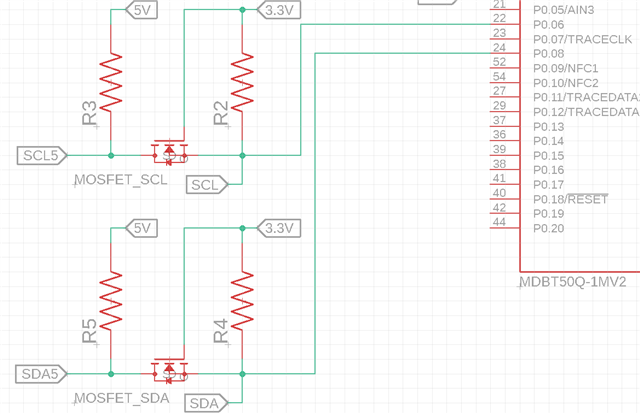

Hello everyone,
using Segger Embedded Studio, I encountered an issue with the TWI libraries. My device consists of a custom PCB controlled by the nRF52840 (programmed with the PCA10056), to which various sensors are connected using the I2C protocol. Some sensors require a 3.3V power supply while one requires 5V. To obtain these two voltages, I use a 3.9V battery connected to a 3.3V regulator, followed by a power booster circuit to increase it to 5V. The I2C line used is shown in the photo.
The 5V sensor is the SPS30 from Sensirion, and it is the one causing issues. I am programming it with a simple code that activates and reads only its values.

The problem is that after this period, the code gets stuck in "nrfx_twim.c" in the loop at line 591, waiting for "transmission_finished" (I observed this using the debugging mode of SES).
I would like to highlight that I have an older device that uses an nRF52832 with the same connections to the SPS30. The only difference is that it is powered at 3.9V, and it works without errors using the same code.
I am unable to identify the issue, as everything works correctly for the first few seconds.
Thank you all for any help and suggestions!
