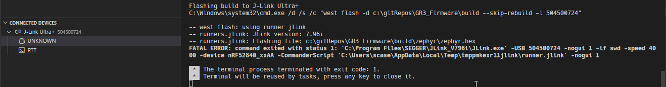

Yesterday I opened the nRF Connect for Windows utility and installed all of the pending updates. Now I am unable to flash or debug the project I'm working on using nRF Connect with a J-Link programmer. I also tried creating a brand new Application from the Blinky sample and flashing that, with the same result.

I rebooted my machine. I completely uninstalled the J-Link software and installed the latest version, then re-added it to the path. I also installed an update version of Nordic Command Line Tools, but after that all, I'm  still back to the same error I was getting before. It seems like something related to a Python script that west uses? I found the .dll file mentioned here, and I do have full control permissions on it. I also tried setting (temporarily) Python to run as admin.
Here is the most informative message I get when trying to program a board. If I try it again after getting this message, it omits the traceback and just goes to the "exited with status 1" bit.
Any ideas?
