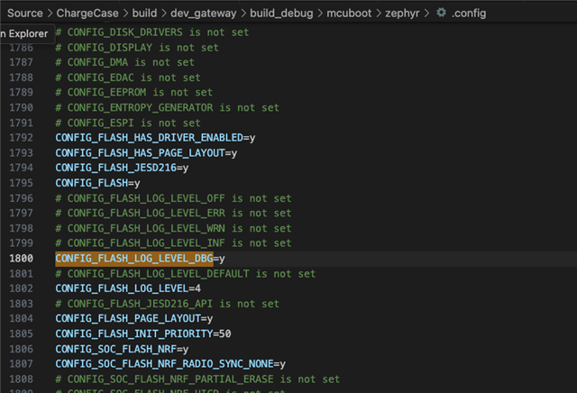

    Can you please check the .conf file in your build output files if there is anything named QSPI that is set to Y? It would be helpful to look at the zephyr.dts file from output folder.

  • This code is running on an NRF5340 chip.
    The code that calls the method flash_area_open() is not ours, it's done in the bootloader. Here's a snippet and a link to the source code:

    Source: https://github.com/mcu-tools/mcuboot/blob/8be24f87e3a1ed514fc989bf3621260b9fb3fb37/boot/bootutil/src/loader.c#L2140
    Generated .config (build/zephyr/.config)

    				prescaler = < 0x1 >;
    			rtc1: rtc@15000 {
    				compatible = "nordic,nrf-rtc";
    				reg = < 0x15000 0x1000 >;
    				cc-num = < 0x4 >;
    				interrupts = < 0x15 0x1 >;
    				status = "disabled";
    				clock-frequency = < 0x8000 >;
    			dppic: dppic@17000 {
    				compatible = "nordic,nrf-dppic";
    				reg = < 0x17000 0x1000 >;
    				status = "okay";
    			wdt: wdt0: watchdog@18000 {
    				compatible = "nordic,nrf-wdt";
    				reg = < 0x18000 0x1000 >;
    				interrupts = < 0x18 0x1 >;
    				status = "okay";
    			wdt1: watchdog@19000 {
    				reg = < 0x19000 0x1000 >;
    				interrupts = < 0x19 0x1 >;
    			comp: comparator@1a000 {
    				compatible = "nordic,nrf-comp";
    				reg = < 0x1a000 0x1000 >;
    				interrupts = < 0x1a 0x1 >;
    				#io-channel-cells = < 0x1 >;
    			egu0: egu@1b000 {
    				compatible = "nordic,nrf-egu";
    				reg = < 0x1b000 0x1000 >;
    				interrupts = < 0x1b 0x1 >;
    				status = "okay";
    			egu1: egu@1c000 {
    				reg = < 0x1c000 0x1000 >;
    				interrupts = < 0x1c 0x1 >;
    				status = "okay";
    			egu2: egu@1d000 {
    				reg = < 0x1d000 0x1000 >;
    				interrupts = < 0x1d 0x1 >;
    				status = "okay";
    			egu3: egu@1e000 {
    				reg = < 0x1e000 0x1000 >;
    				interrupts = < 0x1e 0x1 >;
    				status = "okay";
    			egu4: egu@1f000 {
    				reg = < 0x1f000 0x1000 >;
    				interrupts = < 0x1f 0x1 >;
    				status = "okay";
    			egu5: egu@20000 {
    				reg = < 0x20000 0x1000 >;
    				interrupts = < 0x20 0x1 >;
    				status = "okay";
    			pwm0: pwm@21000 {
    				compatible = "nordic,nrf-pwm";
    				reg = < 0x21000 0x1000 >;
    				interrupts = < 0x21 0x1 >;
    				status = "okay";
    				#pwm-cells = < 0x3 >;
    				pinctrl-0 = < &pwm0_default >;
    				pinctrl-1 = < &pwm0_sleep >;
    				phandle = < 0x1c >;
    			pwm1: pwm@22000 {
    				reg = < 0x22000 0x1000 >;
    				interrupts = < 0x22 0x1 >;
    				status = "okay";
    				pinctrl-0 = < &pwm1_default >;
    				pinctrl-1 = < &pwm1_sleep >;
    				phandle = < 0x1d >;
    			pwm2: pwm@23000 {
    				reg = < 0x23000 0x1000 >;
    				interrupts = < 0x23 0x1 >;
    				status = "okay";
    				pinctrl-0 = < &pwm2_default >;
    				pinctrl-1 = < &pwm2_sleep >;
    				phandle = < 0x1e >;
    			pwm3: pwm@24000 {
    				reg = < 0x24000 0x1000 >;
    				interrupts = < 0x24 0x1 >;
    			pdm0: pdm@26000 {
    				compatible = "nordic,nrf-pdm";
    				reg = < 0x26000 0x1000 >;
    				interrupts = < 0x26 0x1 >;
    			i2s0: i2s@28000 {
    				compatible = "nordic,nrf-i2s";
    				#address-cells = < 0x1 >;
    				#size-cells = < 0x0 >;
    				reg = < 0x28000 0x1000 >;
    				interrupts = < 0x28 0x1 >;
    				status = "okay";
    				pinctrl-0 = < &i2s0_default >;
    				pinctrl-1 = < &i2s0_sleep >;
    			mbox: ipc: mbox@2a000 {
    				compatible = "nordic,mbox-nrf-ipc", "nordic,nrf-ipc";
    				reg = < 0x2a000 0x1000 >;
    				tx-mask = < 0xffff >;
    				rx-mask = < 0xffff >;
    				interrupts = < 0x2a 0x1 >;
    				#mbox-cells = < 0x1 >;
    				status = "okay";
    				phandle = < 0x1a >;
    			qspi: qspi@2b000 {
    				compatible = "nordic,nrf-qspi";
    				reg = < 0x2b000 0x1000 >, < 0x10000000 0x10000000 >;
    				reg-names = "qspi", "qspi_mm";
    				interrupts = < 0x2b 0x1 >;
    				status = "okay";
    				pinctrl-0 = < &qspi_default >;
    				pinctrl-1 = < &qspi_sleep >;
    				w25q64: w25q6435f@0 {
    					compatible = "nordic,qspi-nor";
    					reg = < 0x0 >;
    					sck-frequency = < 0x7a1200 >;
    					sck-delay = < 0xa >;
    					jedec-id = [ EF 40 17 ];
    					sfdp-bfp = [ E5 20 F9 FF FF FF FF 03 44 EB 08 6B 08 3B 42 BB FE FF FF FF FF FF 00 00 FF FF 40 EB 0C 20 0F 52 10 D8 00 00 36 02 A6 00 82 EA 14 C4 E9 63 76 33 7A 75 7A 75 F7 A2 D5 5C 19 F7 4D FF E9 30 F8 80 ];
    					size = < 0x4000000 >;
    					has-dpd;
    					t-enter-dpd = < 0x2710 >;
    					t-exit-dpd = < 0x88b8 >;
    			nfct: nfct@2d000 {
    				compatible = "nordic,nrf-nfct";
    				reg = < 0x2d000 0x1000 >;
    				interrupts = < 0x2d 0x1 >;
    				status = "okay";
    			mutex: mutex@30000 {
    				compatible = "nordic,nrf-mutex";
    				reg = < 0x30000 0x1000 >;
    				status = "okay";
    			qdec0: qdec@33000 {
    				compatible = "nordic,nrf-qdec";
    				reg = < 0x33000 0x1000 >;
    				interrupts = < 0x33 0x1 >;
    			qdec1: qdec@34000 {
    				reg = < 0x34000 0x1000 >;
    				interrupts = < 0x34 0x1 >;
    			usbd: zephyr_udc0: usbd@36000 {
    				compatible = "nordic,nrf-usbd";
    				reg = < 0x36000 0x1000 >;
    				interrupts = < 0x36 0x1 >;
    				num-bidir-endpoints = < 0x1 >;
    				num-in-endpoints = < 0x7 >;
    				num-out-endpoints = < 0x7 >;
    				num-isoin-endpoints = < 0x1 >;
    				num-isoout-endpoints = < 0x1 >;
    				status = "okay";
    				hs_0: hs_0 {
    					compatible = "usb-audio-hs";
    					mic-feature-mute;
    					mic-channel-l;
    					mic-channel-r;
    					hp-feature-mute;
    					hp-channel-l;
    					hp-channel-r;
    			usbreg: regulator@37000 {
    				compatible = "nordic,nrf-usbreg";
    				reg = < 0x37000 0x1000 >;
    				interrupts = < 0x37 0x1 >;
    				status = "okay";
    			flash_controller: flash-controller@39000 {
    				compatible = "nordic,nrf53-flash-controller";
    				reg = < 0x39000 0x1000 >;
    				partial-erase;
    				#size-cells = < 0x1 >;
    				flash0: flash@0 {
    					compatible = "soc-nv-flash";
    					erase-block-size = < 0x1000 >;
    					write-block-size = < 0x4 >;
    					reg = < 0x0 0x100000 >;
    					partitions {
    						boot_partition: partition@0 {
    							label = "mcuboot";
    							reg = < 0x0 0x10000 >;
    						slot0_partition: partition@10000 {
    							label = "image-0";
    							reg = < 0x10000 0x40000 >;
    						slot0_ns_partition: partition@50000 {
    							label = "image-0-nonsecure";
    							reg = < 0x50000 0x30000 >;
    						slot1_partition: partition@80000 {
    							label = "image-1";
    							reg = < 0x80000 0x40000 >;
    						slot1_ns_partition: partition@c0000 {
    							label = "image-1-nonsecure";
    							reg = < 0xc0000 0x30000 >;
    						storage_partition: partition@f0000 {
    							label = "storage";
    							reg = < 0xf0000 0x10000 >;
    			kmu: kmu@39000 {
    				compatible = "nordic,nrf-kmu";
    				interrupts = < 0x39 0x1 >;
    				status = "okay";
    			vmc: vmc@81000 {
    				compatible = "nordic,nrf-vmc";
    				reg = < 0x81000 0x1000 >;
    				status = "okay";
    			gpio0: gpio@842500 {
    				compatible = "nordic,nrf-gpio";
    				gpio-controller;
    				reg = < 0x842500 0x300 >;
    				#gpio-cells = < 0x2 >;
    				status = "okay";
    				port = < 0x0 >;
    				gpiote-instance = < &gpiote >;
    				phandle = < 0x8 >;
    			gpio1: gpio@842800 {
    				gpio-controller;
    				reg = < 0x842800 0x300 >;
    				ngpios = < 0x10 >;
    				status = "okay";
    				port = < 0x1 >;
    				phandle = < 0x1b >;
    			ieee802154: ieee802154 {
    				compatible = "nordic,nrf-ieee802154";
    		spu: spu@50003000 {
    			compatible = "nordic,nrf-spu";
    			reg = < 0x50003000 0x1000 >;
    			interrupts = < 0x3 0x1 >;
    			status = "okay";
    		gpiote: gpiote0: gpiote@5000d000 {
    			compatible = "nordic,nrf-gpiote";
    			reg = < 0x5000d000 0x1000 >;
    			interrupts = < 0xd 0x5 >;
    			status = "okay";
    			instance = < 0x0 >;
    			phandle = < 0x17 >;
    		gpiote1: gpiote@4002f000 {
    			reg = < 0x4002f000 0x1000 >;
    			interrupts = < 0x2f 0x5 >;
    			instance = < 0x1 >;
    		cryptocell: crypto@50844000 {
    			compatible = "nordic,cryptocell", "arm,cryptocell-312";
    			reg = < 0x50844000 0x1000 >, < 0x50845000 0x1000 >;
    			reg-names = "wrapper", "core";
    			interrupts = < 0x44 0x1 >;
    			status = "okay";
    	pinctrl: pin-controller {
    		compatible = "nordic,nrf-pinctrl";
    		i2s0_default: i2s0_default {
    			phandle = < 0x13 >;
    			group1 {
    				psels = < 0x13002b >;
    				nordic,drive-mode = < 0x3 >;
    			group2 {
    				psels = < 0xd002d >, < 0xf002c >, < 0x12002e >, < 0x11002f >;
    		i2s0_sleep: i2s0_sleep {
    			phandle = < 0x14 >;
    			group1 {
    				psels = < 0x13002b >, < 0xd002d >, < 0xf002c >, < 0x12002e >, < 0x11002f >;
    				low-power-enable;
    		uart0_default: uart0_default {
    			phandle = < 0x2 >;
    			group1 {
    				psels = < 0x27 >;
    			group2 {
    				psels = < 0x10028 >;
    				bias-pull-up;
    		uart0_sleep: uart0_sleep {
    			phandle = < 0x3 >;
    			group1 {
    				psels = < 0x27 >, < 0x10028 >;
    				low-power-enable;
    		uart2_default: uart2_default {
    			phandle = < 0x9 >;
    			group1 {
    				psels = < 0x1b >;
    			group2 {
    				psels = < 0x10018 >;
    				bias-pull-up;
    		uart2_sleep: uart2_sleep {
    			phandle = < 0xa >;
    			group1 {
    				psels = < 0x1b >, < 0x10018 >;
    				low-power-enable;
    		uart3_default: uart3_default {
    			phandle = < 0xb >;
    			group1 {
    				psels = < 0x5 >;
    		uart3_sleep: uart3_sleep {
    			phandle = < 0xc >;
    			group1 {
    				psels = < 0x5 >;
    				low-power-enable;
    		i2c1_default: i2c1_default {
    			phandle = < 0x4 >;
    			group1 {
    				psels = < 0xc0022 >, < 0xb0023 >;
    		i2c1_sleep: i2c1_sleep {
    			phandle = < 0x5 >;
    			group1 {
    				low-power-enable;
    		pwm0_default: pwm0_default {
    			phandle = < 0xd >;
    			group1 {
    				psels = < 0x160004 >, < 0x170006 >, < 0x180007 >;
    		pwm0_sleep: pwm0_sleep {
    			phandle = < 0xe >;
    			group1 {
    				low-power-enable;
    		pwm1_default: pwm1_default {
    			phandle = < 0xf >;
    			group1 {
    				psels = < 0x160002 >, < 0x170003 >, < 0x18000c >;
    		pwm1_sleep: pwm1_sleep {
    			phandle = < 0x10 >;
    			group1 {
    				low-power-enable;
    		pwm2_default: pwm2_default {
    			phandle = < 0x11 >;
    			group1 {
    				psels = < 0x16001c >;
    		pwm2_sleep: pwm2_sleep {
    			phandle = < 0x12 >;
    			group1 {
    				low-power-enable;
    		spi4_default: spi4_default {
    			phandle = < 0x6 >;
    			group1 {
    				psels = < 0x4000a >, < 0x5000b >;
    			group2 {
    				psels = < 0x60013 >;
    		spi4_sleep: spi4_sleep {
    			phandle = < 0x7 >;
    			group1 {
    				psels = < 0x4000a >, < 0x60013 >, < 0x5000b >;
    				low-power-enable;
    		qspi_default: qspi_default {
    			phandle = < 0x15 >;
    			group1 {
    				psels = < 0x1d0011 >, < 0x1f000d >, < 0x20000e >, < 0x21000f >, < 0x220010 >, < 0x1e0012 >;
    		qspi_sleep: qspi_sleep {
    			phandle = < 0x16 >;
    			group1 {
    				psels = < 0x1d0011 >, < 0x1f000d >, < 0x20000e >, < 0x21000f >, < 0x220010 >;
    				low-power-enable;
    			group2 {
    				psels = < 0x1e0012 >;
    				low-power-enable;
    				bias-pull-up;
    	rng_hci: entropy_bt_hci {
    		compatible = "zephyr,bt-hci-entropy";
    		status = "okay";
    	sw_pwm: sw-pwm {
    		compatible = "nordic,nrf-sw-pwm";
    		generator = < &timer1 >;
    		clock-prescaler = < 0x0 >;
    	cpus {
    		cpu0: cpu@0 {
    			device_type = "cpu";
    			compatible = "arm,cortex-m33f";
    			reg = < 0x0 >;
    			itm: itm@e0000000 {
    				compatible = "arm,armv8m-itm";
    				reg = < 0xe0000000 0x1000 >;
    				swo-ref-frequency = < 0x3d09000 >;
    			mpu: mpu@e000ed90 {
    				compatible = "arm,armv8m-mpu";
    				reg = < 0xe000ed90 0x40 >;
    				arm,num-mpu-regions = < 0x8 >;
    	ipc {
    		ipc0: ipc0 {
    			compatible = "zephyr,ipc-openamp-static-vrings";
    			memory-region = < &sram0_shared >;
    			mboxes = < &mbox 0x0 >, < &mbox 0x1 >;
    			mbox-names = "tx", "rx";
    			role = "host";
    			status = "okay";
    	nrf_radio_fem: nrf21540_fem {
    		compatible = "nordic,nrf21540-fem";
    		tx-en-gpios = < &gpio1 0xe 0x0 >;
    		rx-en-gpios = < &gpio0 0x9 0x0 >;
    	pwmleds {
    		compatible = "pwm-leds";
    		pwm_led_rgb1: pwm_led_rgb1 {
    			pwms = < &pwm0 0x0 0x1312d00 0x0 >;
    		pwm_led_rgb2: pwm_led_rgb2 {
    			pwms = < &pwm1 0x0 0x1312d00 0x0 >;
    		pwm_led_bottom_white: pwm_led_bottom_white {
    			pwms = < &pwm2 0x0 0x1312d00 0x0 >;
    	reserved-memory {
    		ranges;
    		sram0_image: image@20000000 {
    			reg = < 0x20000000 0x70000 >;
    		sram0_s: image_s@20000000 {
    			reg = < 0x20000000 0x40000 >;
    		sram0_ns: image_ns@20040000 {
    			reg = < 0x20040000 0x30000 >;
    		sram0_shared: memory@20070000 {
    			reg = < 0x20070000 0x10000 >;
    			phandle = < 0x19 >;
    	leds: leds {
    		compatible = "gpio-leds";
    		rgb1_red: led_0 {
    			label = "0 LED_RGB_RED CORE_APP";
    		rgb1_green: led_1 {
    			label = "0 LED_RGB_GREEN CORE_APP";
    		rgb1_blue: led_2 {
    			label = "0 LED_RGB_BLUE CORE_APP";
    			status = "okay";
    	buttons {
    		compatible = "gpio-keys";
    		iqs_ready: iqs_ready {
    			gpios = < &gpio1 0x5 0x11 >;
    			label = "IQS Ready";
    	nrf5340_audio_dk {
    		iso_switch: iso_switch {
    			gpios = < &gpio0 0x19 0x0 >;
    			label = "ISO switch";
    		pull_ctrl: pull_ctrl {
    			gpios = < &gpio1 0x9 0x0 >;
    			label = "Pull CTRL";
    		vchgr_en: vchgr_en {
    			gpios = < &gpio0 0x17 0x0 >;
    			label = "VCharge Enable";
    		vchgr_hi_en: vchgr_hi_en {
    			gpios = < &gpio0 0x1e 0x0 >;
    			label = "VCharge HI Enable";
    		case_rx: case_rx {
    			gpios = < &gpio0 0x18 0x0 >;
    			label = "Case RX";
    		case_tx: case_tx {
    			gpios = < &gpio0 0x1b 0x0 >;
    			label = "Case TX";
    		disp_res_out: disp_res_out {
