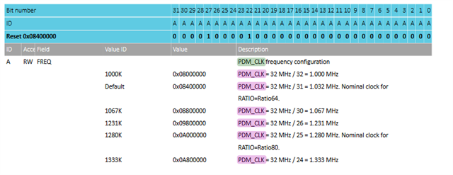

    ret_code_t err_code;
    uint32_t clk_freq = 0x19000000;
    nrfx_pdm_config_t config = NRFX_PDM_DEFAULT_CONFIG(PDM_CONFIG_IO_PDM_CLK, PDM_CONFIG_IO_PDM_DATA);
    config.gain_l = rec_config.gain;
    config.gain_r = rec_config.gain;
    config.clock_freq = ( nrf_pdm_freq_t )(clk_freq);
    config.edge = PDM_MODE_EDGE_LeftFalling;
    config.mode = PDM_MODE_OPERATION_Stereo;
    // set ratio to 80x
    NRF_PDM->RATIO = 1;
    err_code = nrfx_pdm_init(&config, PDM_drv_pdm_handler);
    err_code = nrfx_pdm_start();

  • Hi again Obaid
    Okay, thank you for the clarification. It seems very strange that it would swap like this. Would it be possible for you to use a scope to check the left-right word alignment for both scenarios so we can see if this is the driver that messes up or what. I have asked a bit around but we can't recall seeing this issue in the past unfortunately.
