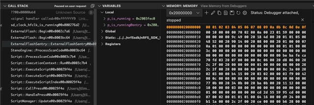

Hi, I recently noticed crashing in sd_clock_hfclk_is_running() on a nrf52840 using SoftDevice S140 7.3.0. This is the callstack:
??@0x00000ac4 (Unknown Source:0)
<signal handler called>@0xffffffe9 (Unknown Source:0)
sd_clock_hfclk_is_running@0x000276ae (.../nRF5_SDK_17.1.0_ddde560/components/softdevice/s140/headers/nrf_soc.h:720)
I'm using the following to enable the hfclk whenever I enable QSPI to avoid errata 244:
sd_clock_hfclk_request();
uint32_t isHfclkRunning = 0;
do {
  APP_ERROR_CHECK(sd_clock_hfclk_is_running(&isHfclkRunning));
} while (!isHfclkRunning);
I can trigger this somewhat reliably if I unplug and plug usb power while this code triggers.
Any tips on how I can avoid this issue?

    I was informed by our experts about another suspicion after looking more closely at your callstack contents,
    That line there on top of your callstack makes us suspect that the content of address 0x20000000 (so the first address in RAM), has been corrupted somehow.
    Please check that before you call sd_clock_hfclk_is_running().
    The content should, in your case, always be 00001000. it is that address at which the MBR stores where to forward interrupts and 0x1000 will make MBR forward interrupts to Softdevice.
    You can check this, for example, by adding the following code before the call to sd_clock_hfclk_is_running that fails, and see if you get stuck there, and tell us what the value at 0x20000000 is if it hangs there:
    if(*((uint32_t*)0x20000000)!=0x1000)
    while(1);
    Or maybe you can just connect with debugger and see what content is at 0x20000000 when the program has crashed.
    -Priyanka
  • The value seems right -- `00 10 00 00` bytes at the address. Note that another reason I don't think it's the interrupt disabled issue is that when I replace the sd_clock_hfclk_is_running with my manual register lookup, it all works, despite there being a sd_clock_hfclk_release call later, which should also crash according to that theory.

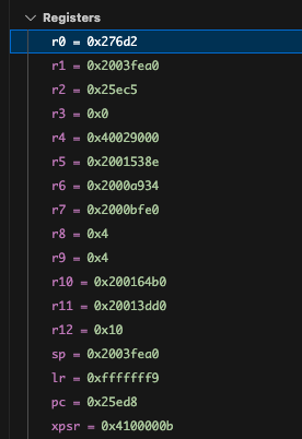

  • I tried this again today, and the `NRF_CLOCK->EVENTS_HFCLKSTARTED == 0` works, but testing with the old sd_clock_hfclk_request() approach again gave me a different callstack:
    The call hung, and stopping execution landed on 0x25ed8:
    0x00025ed2: mrs r1, MSP
    0x00025ed6: ldr r0, [r1, #24]
    0x00025ed8: subs r0, #2
    0x00025eda: ldrb r0, [r0, #0]
    0x00025edc: cmp r0, #16
    0x00025ede: blt.n 0x25f08
    Sharing this in case it helps at all.

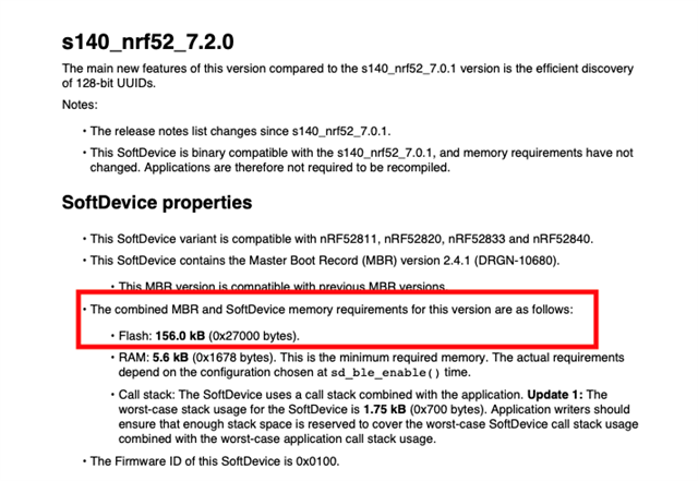

  • Thanks for sharing latest stack frame, Im not able to see anything interesting from it, other than that now the fault seems to happen somewhere in  your application (beaus 0x25ed8 is higher than the highest address in s140).  or is 0x25ed8 just an adress in your hardfault-handler maybe?
    Since it happens on many different boards, and also on pretty fresh boards then I think we can rule out flash-wearing too.
    Coretex has concept of two differint stacks, msp and psp. one for "main mode" (also called "thread mode), that cpu is using when it is not handling interrupts, and another callsstack it uses for interrupts. it is optional to use two different stacks for interrupts and "main mode", so I'm not sure what your application does.
    But all of the code in Softdevice anyway runs in interrupt mode, since all the calls to Softdevice is implemented as SVC interrupts.  And since there is only one callstack for all interrupts, Softdevice and application end up sharing the same callstack.
