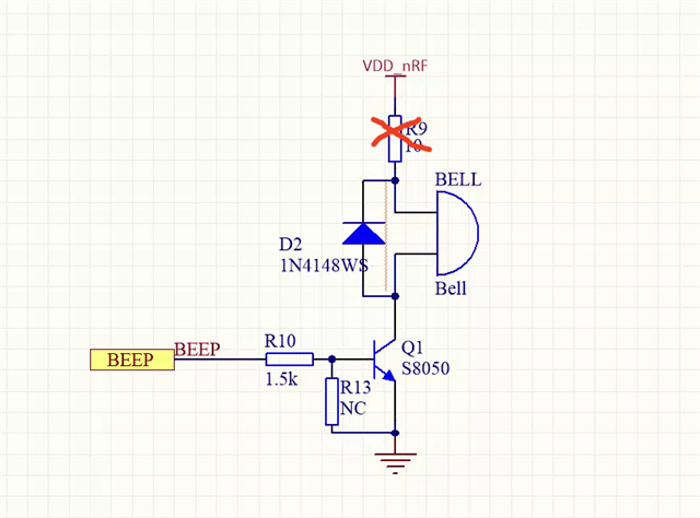

My schematic design is as follows:I use an internal pull-up resistor in the CPU.
