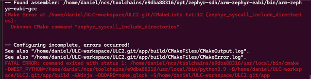

I am attempting to build a project off of the XXX template repository. So far I have gotten the workspace set up and am now attempting to run "west build" but I get the below error. This looks like CMake just can't find a custom zephyr module/plugin but I can't seem to find help anywhere for pointing CMake at the right *.cmake files. Am I missing something? Thanks!

  • Sure! I am using v2.6.1 of the toolchain and the SDK. This error occurs for any of the builds I attempt to run from the command line that uses the template/structure found in https://github.com/nrfconnect/ncs-example-application. I have also already set up the environment using "nrfutil toolchain-manager launch --shell"
    (v2.6.1) daniel@JUS-L-B5C2TW3:~/Documents/ULC-Workspace/ULC2.git$ west build --board=noke_glock -p
    CMake Error at CMakeLists.txt:12 (zephyr_syscall_include_directories):
      Unknown CMake command "zephyr_syscall_include_directories".
    See also "/home/daniel/Documents/ULC-Workspace/ULC2.git/build/CMakeFiles/CMakeOutput.log".
    FATAL ERROR: command exited with status 1: /home/daniel/ncs/toolchains/2be090971e/usr/local/bin/cmake -DWEST_PYTHON=/home/daniel/ncs/toolchains/2be090971e/usr/local/bin/python3.9 -B/home/daniel/Documents/ULC-Workspace/ULC2.git/build -GNinja -DBOARD=noke_glock -S/home/daniel/Documents/ULC-Workspace/ULC2.git
    Thanks!

  • I used west init. To start from the beginning I...
    • nrfutil toolchain-manager launch --shell
    • west init -m [github repo].git my-workspace
    • cd my-workspace
    • west update
    • source zephyr/zephyr-env.sh (I have tried with and without this step)
    • cd ULC.git
    • west build
    and I always end up with this output
    (v2.6.1) daniel@JUS-L-B5C2TW3:~/Documents/my-workspace/ULC2.git$ west build --board=noke_glock
    See also "/home/daniel/Documents/my-workspace/ULC2.git/build/CMakeFiles/CMakeOutput.log".
    FATAL ERROR: command exited with status 1: /home/daniel/ncs/toolchains/2be090971e/usr/local/bin/cmake -DWEST_PYTHON=/home/daniel/ncs/toolchains/2be090971e/usr/local/bin/python3.9 -B/home/daniel/Documents/my-workspace/ULC2.git/build -GNinja -DBOARD=noke_glock -S/home/daniel/Documents/my-workspace/ULC2.git
    I can't seem to find any reference anywhere to "zephyr_syscall_include_directories" besides the CMakeLists files in the sample projects from nordic and zephyr. Is it possible it's compiled into something? I assumed it was going to be defined in a *.cmake kinda file(that I'm failing to include), but that doesn't seem to be the case.
