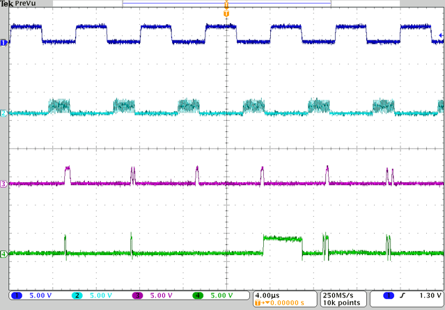

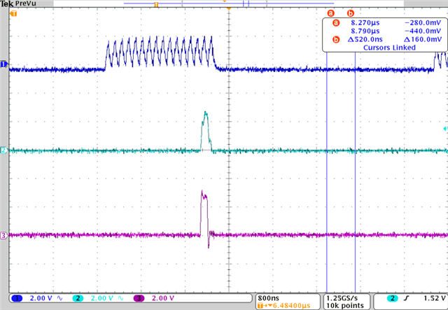

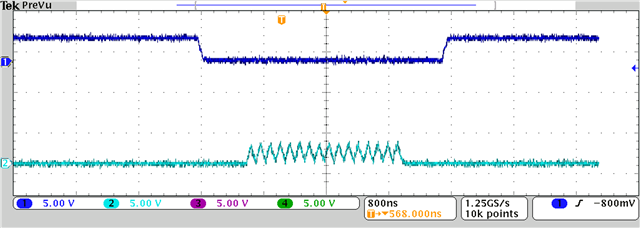

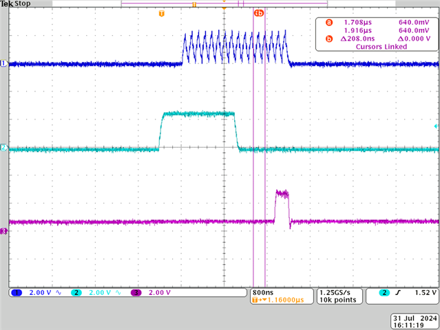

< my issue>
If TIME_TO_WAIT_US is less than 10, SPIM communication does not work properly. (ADC spec: Maximum SCLK frequency is 25 MHz)
I think a lot of time is being consumed in the handler. I'm not sure exactly what the problem is.
I want SPIM to work properly when 'TIME_TO_WAIT_US' is 5~6.
Could you give me some advice?
