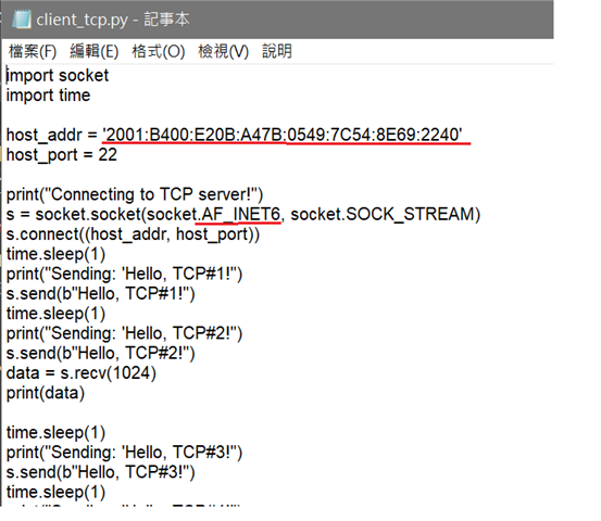

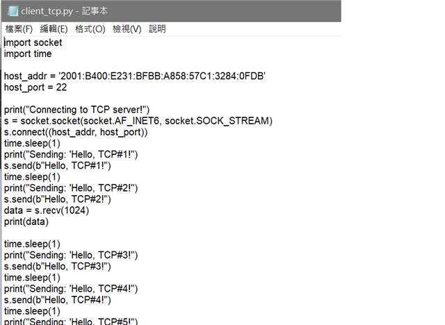

    2.  I also tried IPV6 address as you mentioned.
    At TCP server side, got below IPV6 address
    Then, edited python script

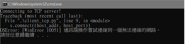

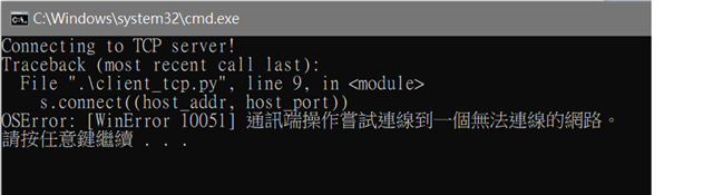

    However, as ran this script, the terminal showed error message immediately.
    The Chinese sentence means the IPV6 address cannot be reached.

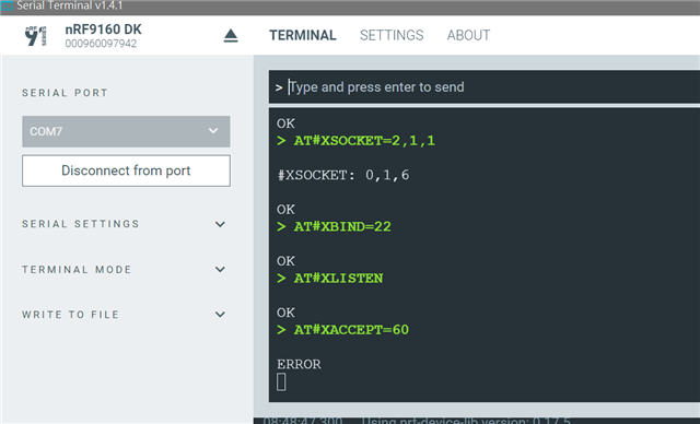

    Have you used proper #XSOCKET command for opening a socket for IPv6, #XSOCKET=2,1,1?
    Dejan
  • Yes. As below, "AT#XSOCKET=2,1,1".
    The result of connecting by IPV6 was different to IPV4.
    Using IPV4, TCP client (python script) did try to connect the server but timeout error.
    Using IPV6, script halted very soon and showed address cannot be connected.  It seems nothing about
    connecting timeout.

    I have tested myself. I tried to reproduce your error but got the Timeout Error. However, we have tested this internally and result was successful. It might be that your operator does not allow incoming IPv6 (or IPv4) for your SIM card (which I assume also happens in my case). You could first try to test your IPv6 connectivity (for example by running "ping -6 ipv6.google.com") from your computer and if this is successful you can reach out to your network operator with further inquiries.
