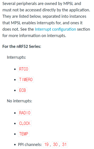

Timer 1 and Timer 2 works perfectly as I expected. You can check it on the Segger RTT Viewer (upper image)
However, Timer 0 doesn't cleared correctly and just keep increasing it's value. Can you please chek on your side?
FYI, I am using SPIM and TWIM simultaneously. Could it impact on Timer 0's unexpected behavior?
