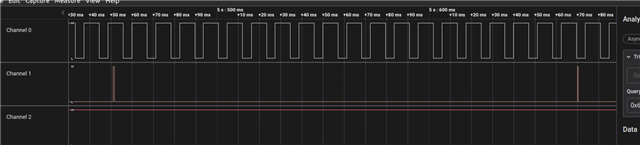

  • hi,
    I made GPIO toggling. I set gpio in timesloat_begin_handler and clear in timeslot_and_handler (I push it).
    Here is the image when it changes from good to bad, white signal is the receiver side brown is the sender.
    And this is caused by reconnecting BLE (after reconnect it remains good for about 4-5 sec) of sender device.
    When it is good there is ~213ms between packet sending. When it comes to bad this time increase a little ~220ms for some packet then it comes to be 213 again but after that as shown in the picture packet sending happens when receiver not listen.
    Is there any possibility to make back this time shift?
    besta regards
  • Hi Attila,
    Audun had some time to test this code and his observations are that, it appears to be a case of MPSL scheduling not aligning properly with the time sync radio packets. Your code uses a 25 ms advertising interval, and with the advertising randomness, Audun suspect there is simply too many scheduling collisions to get a useful number of received sync packets.
     Increasing the advertising interval to 100 ms (mAPP_ADV_FAST_INTERVAL = 0x00A0), things improve quite a bit. The receiver has no long pauses in packet reception now, but I do see the rate of packet reception goes a bit up and down.
    In the test code you need to calibrate the advertising interval and in your main code you need to fine tune the BLE activity to be able to have less timeslot collisions, Ideally the time sync code should be updated to make the radio RX actively align with the TX. In its current form, the receiver always tries to keep the radio in RX as much of the time as possible, while the transmitter only requests MPSL timeslots when it needs to transmit packets (which is a fixed interval). Updating the time sync code is a bigger task than just trying to calibrate the BLE parameters and advertising interval.
    I test what you mention but not solved the problem for me. But during advertising time sync packets arrived, the problem starts after both device is connected and sync packet sender connects later.
    Changing the sending frequency from the default 30 to 150 (ts_tx_start()) solves the problem. But maybe is there a better solution?
