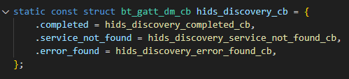

  • You need to check why the discovery callback is called for HID even though you have registered the callback to be called only for BAS.
    This was the key, I discovered that I had set the same callbacks for HID and BAS, so I separated them:
    Now I can succesfully receive the BAS notiications!

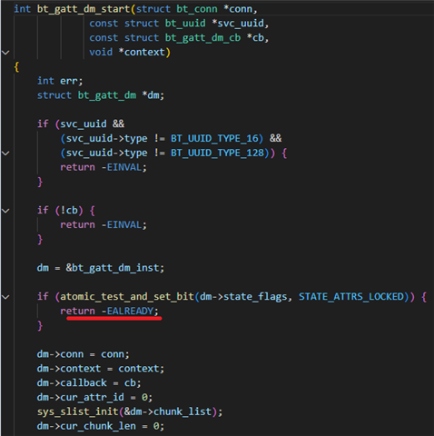

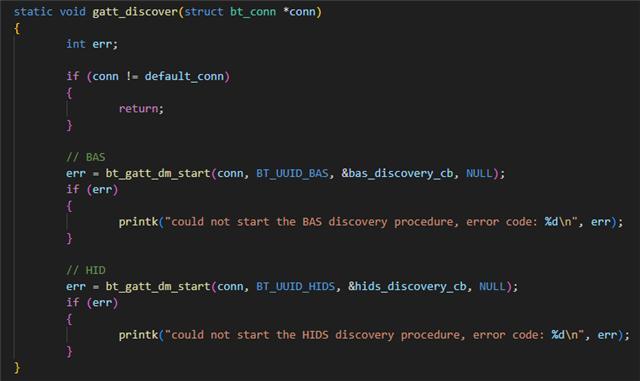

    One last issues I have is that if I call bt_gatt_dm_start() on the BT_UUID_BAS first, the next call with BT_UUID_HIDS fails with EALREADY (socket already in use):
    and vice versa if I call HIDS first and BAS second.

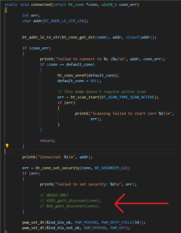

    What I understand from this, and pardon possible imprecisions, is that a single BLE connection object can only be set to a single GATT service..? In that case I need a way to check the UUID of the GATT service I just connected to inside the following connected() BLE callback:
    I also think that I need two different scanning functions given that I want to use both HIDS and BAS together, where the difference would just be the target UUID.
    No, you can use the same connection handle to set discoveries on different UUIDs but not at the same time. Best way to do this in my opinion is to start the discovery on one UUID (say on BAS first) and when you have the discovery complete callback, then start the discovery on the other (HIDS). I have done this before and had no issues  Just make sure that the callback handlers for both are different so that your application is not confused.
  • Calling bt_gatt_dm_start(conn, BT_UUID_BAS, &bas_discovery_cb, NULL); inside the HIDS_discovery_complete_cb() did the trick!
