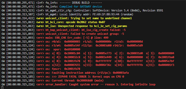

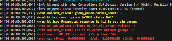

But when it will crashed when the gateway started to run:
So what is the problem? How can i can implement the function of more than two headset connect to one gateway.

    The nRF5340 Audio: Unicast client currently supports up to 2 headsets, one for left and one for right.
    The default configuration will try to allocate high-quality QoS settings for two headsets. Trying to extend the BT_MAX_CONN will make the controller cannot allocate the proper resource (out of bandwidth). The crash error code shows the controller cannot allocate proper timing resources when creating CIG (connected isochronous group).

    Unfortunately, the current audio application cannot support more than 2 headsets
    1. The CPU resource is not enough since stereo channels could need ~66% CPU. It will increase the CPU workload while using the USB interface. It also requires more CPU workload to decode with BIDIR.
    2. The current configuration on the unicast client is for connecting two headsets and then setting them separately for L and R channels. Then the unicast client will send the streams to each of them. The application won't be able to support the extra headsets.

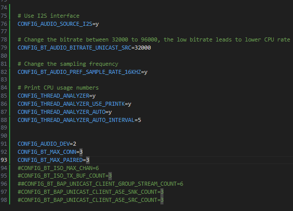

    Now I am using the I2S in, so the USB function actually disabled. I want to ask if i only use the I2S in, is there enough resources can connect more than two headsets?

    But you could make a trial with
    1. In the default CIS demo, add the following configs for evaluating the CPU usage
    # Use I2S interface
    CONFIG_AUDIO_SOURCE_I2S=y
    # Change the bitrate between 32000 to 96000, the low bitrate leads to lower CPU rate
    CONFIG_BT_AUDIO_BITRATE_UNICAST_SRC=32000
    # Change the sampling frequency
    CONFIG_BT_AUDIO_PREF_SAMPLE_RATE_16KHZ=y
    # Print CPU usage numbers
    CONFIG_THREAD_ANALYZER=y
    CONFIG_THREAD_ANALYZER_USE_PRINTK=y
    CONFIG_THREAD_ANALYZER_AUTO=y
    CONFIG_THREAD_ANALYZER_AUTO_INTERVAL=5
    2. You would need to figure out a way to input a multiple-channel audio stream since I2S only supports two channels.
    If you are not going to send live streams, you could store the encoded LC3 in the SD card or flash and then send the encoded streams.

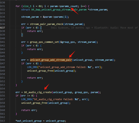

    3. You would need to study the nrf/applications/nrf5340_audio/src/bluetooth/bt_stream/unicast/unicast_client.c because that is the core of the unicast client.
    A lot of exchange will be expected. Here is a reference based on old NCS for showing how to make the unicast client be able to handle multiple unicast servers https://github.com/alexsven/sdk-nrf/commit/68a7ac3452a5c55a25ab275d761393dbdea4d5df
