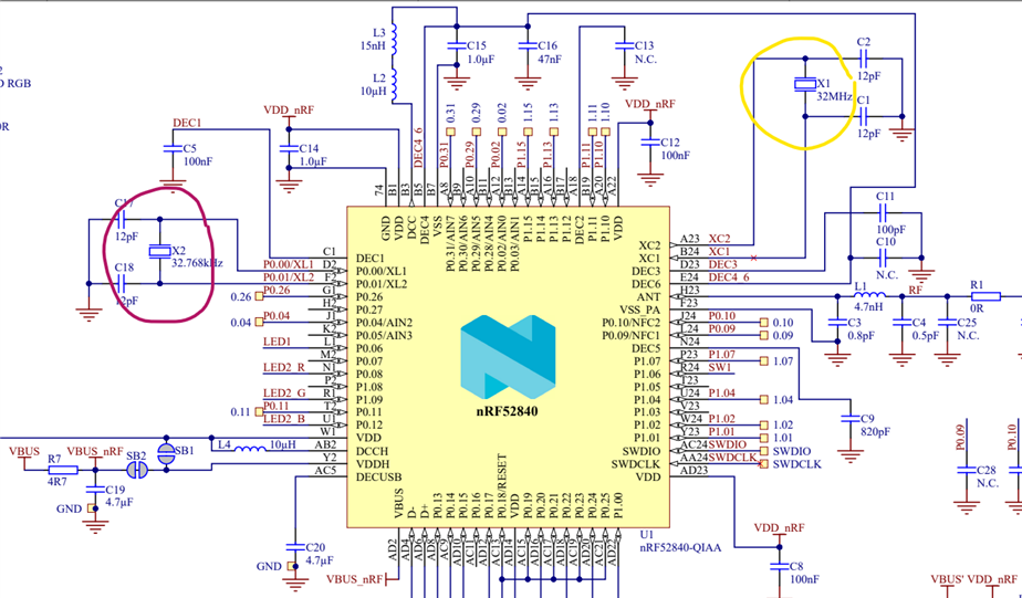

Hi everyone,
I'm encountering difficulties running my application on a custom nRF52840 board with a 48-pin package using Zephyr NCS version 2.4.4 in VS Code.
The problem arises when the k_msleep function is called, causing the system to halt. The same code runs without issues on an nRF52840 DK. Both boards utilize a 32MHz crystal oscillator.
To troubleshoot, I've tried debugging the application but haven't found any clear culprits yet.
Here's a breakdown of my setup:
  • Hardware: Custom nRF52840 board with 48-pin package, 32MHz crystal oscillator (no external crystal)
  • Software: Zephyr NCS version 2.4.4, VS Code
  • Application: Includes threads, timers, ADC, and BLE functionalities
I suspect that the absence of an external crystal on my custom board might be the root cause of the issue, but I'm not certain.
I would appreciate any insights or suggestions on how to proceed with troubleshooting
this is the Pinout of 72 pin package but in my board we have 48 pin package
