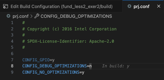

I am setting CONFIG_DEBUG_OPTIMIZATIONS by selecting:
However, it seems not sufficient as there are probably some optimisations that are made on the code.
I remember when debugging on nRF52, I had to set:
so `-O0 -g3` flags in order to propely debug and I think I need to also enable `CONFIG_NO_OPTIMIZATIONS` but I can't override its value together with `CONFIG_DEBUG_OPTIMIZATIONS`.

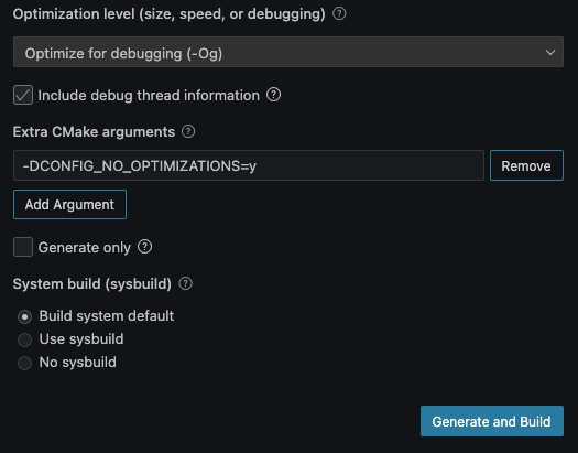

  • This should be solvable by disabling optimizations.

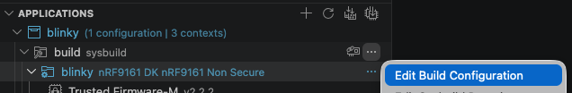

    If you are using the nRF Connect for VSCode extension, edit the build configuration:
    and set it to debug mode, but also add the CMake arg here:
    -DCONFIG_NO_OPTIMIZATIONS=y
    and click the blue button (important!).
