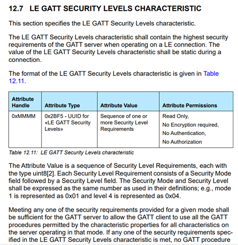

    May I ask how to choose to advertise in S=2 or S=8 with LE coded PHY?
    Also, how to add a characteristic to the GAP service? I am trying to create the security level characteristic.
    I am using the SDK v2.7.0.
    Thank you.
    Please do not mix many questions in one into a thread. This one is a basic question that has been asked before. But let me try to explain this one.
    You can add a characteristic with security to a service by defining the characteristic and its properties, and then adding it to the service. Here's a general example of how to do it:
    #include <bluetooth/gatt.h>
    /* GATT service declaration */
    BT_GATT_SERVICE_DEFINE(my_service,
        BT_GATT_PRIMARY_SERVICE(&my_service_uuid),
        BT_GATT_CHARACTERISTIC(&my_char_uuid.uuid, &my_char_props,
                               BT_GATT_PERM_READ_AUTHEN,
                               read_callback, write_callback, &my_value),
    BT_GATT_SERVICE_DEFINE is a macro that defines a GATT service. BT_GATT_PRIMARY_SERVICE is a macro that defines a primary service. BT_GATT_CHARACTERISTIC is a macro that defines a characteristic.
    my_service_uuid and my_char_uuid are the UUIDs of the service and the characteristic, respectively. my_char_props are the properties of the characteristic. BT_GATT_PERM_READ_AUTHEN is the permission for the characteristic, which requires authentication for read access. read_callback and write_callback are the read and write callbacks for the characteristic. my_value is the initial value of the characteristic.
    Please note that the actual code may vary depending on your application requirements and the version of Zephyr you are using.
    For more information, you can refer to the Zephyr documentation.
    For adding a characteristic with a specific security level, you can set the permissions of the characteristic to BT_GATT_PERM_READ_ENCRYPT or BT_GATT_PERM_READ_AUTHEN for read access, and BT_GATT_PERM_WRITE_ENCRYPT or BT_GATT_PERM_WRITE_AUTHEN for write access. These permissions require encryption or authentication for read or write access, respectively.
    Also check if these pages on Security is of some help.
