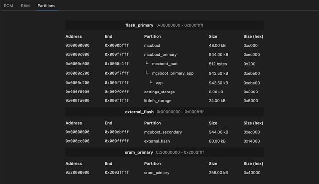

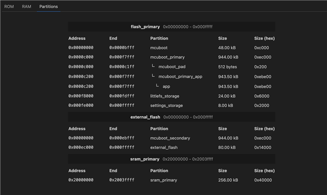

Despite my efforts, I am encountering issues with incorrect partition information for the LittleFS storage. Here are the details of my current configuration:
I found various article but no solution and also i see wrong partition information
littlefs_storage:
  address: 0x00700000
  end_address: 0x00800000
  placement:
    before:
      - end
  region: external_flash

Issues Encountered:
  1. Enabling Bluetooth in the LittleFS sample app causes the LittleFS to NOT use external flash.*
  2. Problems with binding external flash (external flash + SPI + OTA). **
I have scoured through various articles, the Zephyr documentation, and forums, including Discord, but have yet to find a viable solution.
Could you please provide guidance or suggestions on resolving these issues?
* Enabling Bluetooth to the Littlefs sample app will make the littlefs **NOT** use external flash.
** External Flash get binding is Issue. (external flash + spi + OTA)

    #Partion manager
    CONFIG_PM_EXTERNAL_FLASH_MCUBOOT_SECONDARY=n
    seems not working, because of
    external_flash:
    address: 0x0
    littlefs_storage:
    address: 0x0
    device: is25lp064a
    Anything to force this?
    the build log looks good.
    Also my app doesn't start correctly - non output on RTT.  Also without automount!
    BR S

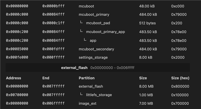

  • I got a little further,
    a restart of the system and before flash manually trigger the build brings now the right paritions.
    It uses now 1MB as configured but the mounting point is not showing up
    Where i could debug the mounting point?

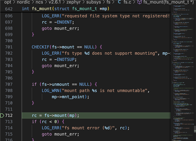

    00:00:00.559,448] <inf> littlefs: LittleFS version 2.5, disk version 2.0
    [00:00:00.559,478] <dbg> littlefs: littlefs_flash_init: FS area 9 at 0x700000 for 1048576 bytes
    [00:00:00.559,600] <err> fs: fs mount error (-22)
    [00:00:00.559,631] <err> data_archive: FAIL: mount id 9 at /lfs1: -22
    [00:00:00.559,661] <err> fs: mount point not found!!
    [00:00:00.559,692] <err> data_archive: FAIL: open /lfs/archive.dat: -2
    How to fix the invalid -22 mountpoint!
