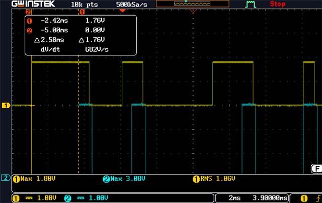

My team is developing a wearable that has time constraints which, we believe, are not being respected by Zephyr.
The setup is a nRF52840 based board which is connected to a chip (AS7058A by ams OSRAM) that communicates via I2C.
The chip has an interrupt line which triggers a callback that submits a worker to handle the I2C communiations.
The issue here is the high latency (can be above 2.5ms) between the interrupt rising edge on the chip and its respective detection on the nRF52840 Zephyr based application.
Here is a picture of an oscilloscope measuring the chip interrupt line (yellow) and a pin output (blue) set on interrupt handling (not on the worker).
As shown, interrupt detection has a variable latency and can go above 2.5ms, but sometimes it can be a few us.

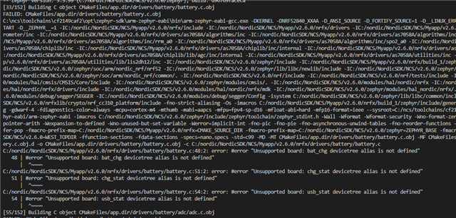

  • Hi Ricardo,
    Thanks for the info. Now I can build and see the same IRQ_CONNECT complain.
    From what I can see it's because the battery library you have, it uses Zephyr's GPIO driver (in Kconfig in drivers\battery it select GPIO)
    You will see the same error if you change CONFIG_GPIO = y in the default nrfx sample.
    The problem is that Zephyr's GPIO driver also defines a IRQ handler for GPIO causing a conflict with the IRQ_CONNECT define in nrfx sample.

  • Hello  ,
    So the problem was not the problem...
    It was an hardware issue, and I incorrectly assumed it was a Zephyr issue.
    The GPIO generating the interrupt was 1.8V and the board (VDD) was 3.0V.
    As GPIO requires 0.7xVDD to measure logic high, it sometimes took a few ms while to detect it.
    I changed the supply to generate a 3V interrupt and now interrupt handling is instantaneous (~20us) as expected.
