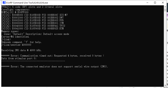

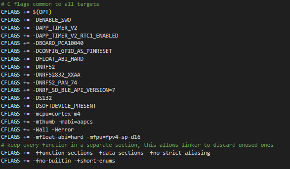

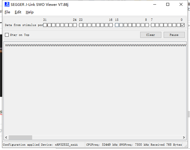

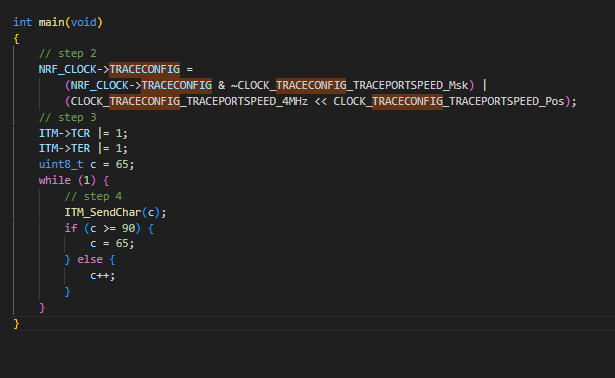

i have used this case:devzone.nordicsemi.com/.../using-swo-with-nrf52-redux  and add ENABLE_SWO  but when i flash and use jlink swo viewer,it will have this problem.
if use jlink.exe and input command.it will have this problem.it can't receive swo debug
