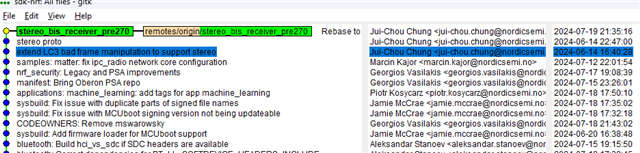

  • Hi. I am also trying to get stereo example working, but I get a build error. With the original v2.8.0\nrf directory it just works. I hope you could help me to correct my way of building it. I take these steps:
    - Open cmd prompt
    - Type: cd ncs\v2.8.0
    - Type: git clone https://github.com/rick1082/sdk-nrf
    - Type: cd sdk-nrf
    - Type: git checkout stereo_bis_receiver_pre270
    - Type: cd applications\nrf5340_audio\tools\buildprog
    - Type: buildprog.py -c both -b debug -d both
    | snr | snr conn | device | only reboot | core app programmed | core net programmed |
    | 1050121107 | ←[33mFalse←[0m | headset | Not selected | Selected | Selected |
    | 1050197742 | ←[33mFalse←[0m | gateway | Not selected | Selected | Selected |
    | 1000 | ←[33mFalse←[0m | headset | Not selected | Selected | Selected |
    Invoking build step
    Net core uses precompiled hex or child image
    Run: west build C:\ncs\v2.8.0\sdk-nrf\applications\nrf5340_audio -b nrf5340_audio_dk/nrf5340/cpuapp --sysbuild -d C:\ncs\v2.8.0\sdk-nrf\applications\nrf5340_audio\build\dev_headset\build_debug
    ninja: error: loading 'build.ninja': The system cannot find the file specified.
    FATAL ERROR: command exited with status 1: 'C:\Program Files\CMake\bin\cmake.EXE' --build 'C:\ncs\v2.8.0\sdk-nrf\applications\nrf5340_audio\build\dev_headset\build_debug'
