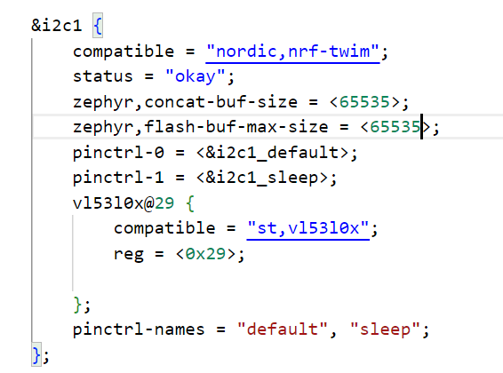

I am developing a firmware to interface CH101 sensor, which has a firmware loading of 2048 bytes of data over I2C.
I declared buffer size as below in device tree and in program I have given 128 bytes transfer in single I2C write call then it worked:
I want to write entire 2048 bytes in single I2C transfer, then I increased the buffer size to 65536 as mentioned below in device tree:
this is the error I am facing,
Q1: Will I2C supports buffer size of maxmium 65536?
Q2: If I2C buffer max size supports 65536 then why I2C write for 2048 bytes is getting failed? In fact, the board is getting reset when I declare this much buffer size when the particular I2C_write is called.
