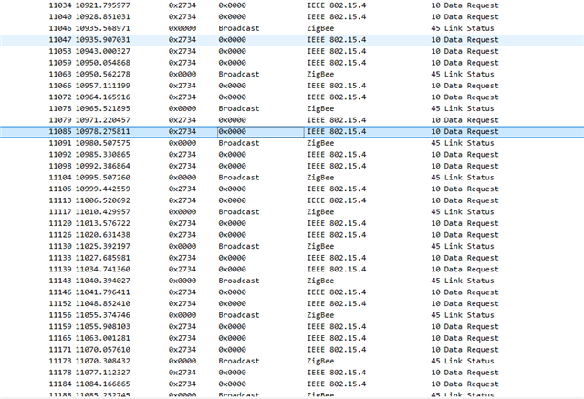

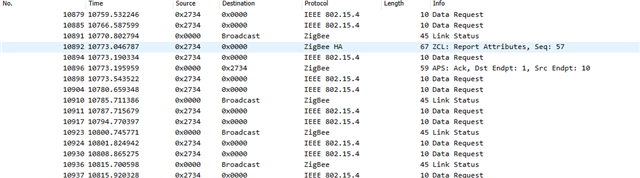

We are developing a ZigBee-based end device using the nRF52840. We have implemented most of the functionalities and also reporting and are able to receive reporting information on the coordinator (Deconz -Conbee). Though most of the time, the reporting works properly, sometimes the reporting fails even with less zigbee traffic (one end device and coordinator in the network).  When we print the status code in the reporting callback (zb_zcl_reporting_cb) we get -1192. Also we don't see any reporting information in the Wireshark logs. (Please find the attached screenshots of wireshark log)
The log printed when reporting Fails is :
zb_zcl_reporting_cb param, send status fffffb58.

Below  is the screenshot of wireshark logs when there is successful reporting
Below  is the screenshot of wireshark logs when the reporting fails and we have the error code.
