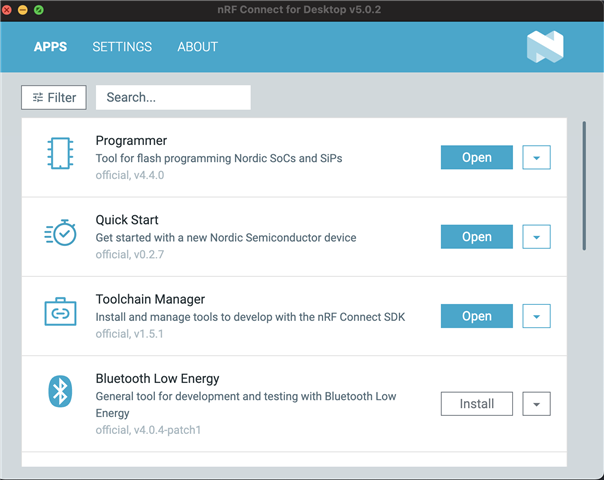

    Could you tell me your nRF Connect for Desktop and Programmer versions?

    Thanks for the reply, Here is a screenshot of the nRF Connect and Programmer apps. I downloaded the latest ones.
