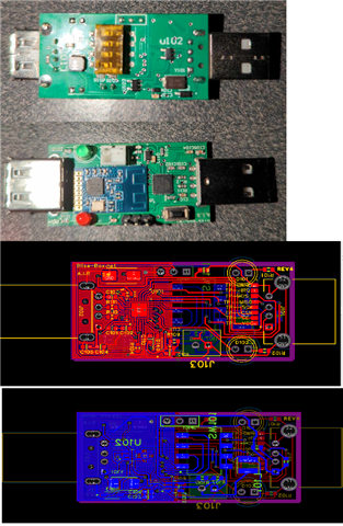

Hi, in the beginning of development my range of the NRF24+ was around 40 feet. My target was only 6. I have gone thru a lot of PCB revisions and mostly do my testing on the bench. After some struggles with firmware things are once again working. but when I started to separate the distance I lost a lot of communication.  I can set up the two modules to work side by side ( 2 feet apart) and things just start failing at 3 feet. Admittedly we didn't concentrate too hard on the antenna placement because 40 feet was way over the mark. I really am hoping my issues is still firmware, but unsure. The wireless boards could be removed but it will be messy. I can also do one of the hack jobs to extend the range I saw online but again, messy. I'd like to rule out firmware first.
Here are a few images, happy to provide missing details. Are there concerns here?

Note about config 6: I think my goals was to use 18db and  rate of 2mb speed but it looks like I set 0x0f. I also tried 0x08 but regardless I'm very confused on the datasheet. It gives the examples:
00’ – 1Mbps
‘01’ – 2Mbps
‘10’ – 250kbps
‘11’ – Reserved
but says you set it on bit 3. So that is a range of 1 bit, not 2?
