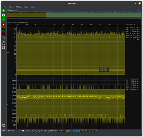

I've been testing the nPM1300 and I'm running into some interesting issues. I'm using NCS 2.7.x (originally evaluated on 2.6.x) and got it to the sweet spot where the nRF9161 + nPM1300 was drawing < 10uA. (or so I thought until I revisited it!)
Here's how it's being used:
  • Initializing buck2 with a 255K resistor supplying 3.3V
  • Keeping buck1 on at all times at 2.7V (255K resistor) (are these VSET values OK for maxing out the regulator?)
  • All LDO output/inputs are grounded and unused
Buck2 is only used when USB is connected. When disabled, I'm seeing a range of quiescent currents from 8uA up to 108uA depending on when the device is being configured (Seems like possibly related to https://docs.nordicsemi.com/bundle/errata_nPM1300_Rev1/page/ERR/nPM1300/Rev1/latest/anomaly_300_31.html?) I saw that reading from the device prevents this high Iq but it still seems higher than expected.
Additionally, as a different issue but potentially related, whenever I probe the SDA line with my multi-meter, nPM1300 increases current draw to 1mA and doesn't go back down unless reset.
has already looked at the design and I've addressed the functionality concerns a while back.
Is there anything I can do to get the operation to be more stable/repeatable? Depending on how long the device is powered (or not powered at all) I get different quiescent currents at the battery. (Powered only on 3.6V on a bench supply via a JouleScope)
By the way my device tree def is as follows:

To add to the fun, I've noticed that when warmer I get closer to the expected quiescent current of about 4uA. (measured post hot air rework) Once it cools off it can land anywhere in the aforementioned range.

    It sounds like one or more GPIOs are floating, based on your description here:
    Could you share your compiled zephyr.dts file? Are you using internal pull-resistors on your SDA/SCL lines?

    This is for the application side.
    No I am not. I'm using external 20k resistors.
  • Looks like the flash driver no longer puts the flash into DPD after init. I elected to put it in manually with this:
    int nor_storage_init(void)
      static const struct device *spi_nor = DEVICE_DT_GET(DT_NODELABEL(w25q32jv));
      /* Disable console UART */
      int err = pm_device_action_run(spi_nor, PM_DEVICE_ACTION_SUSPEND);
      if (err < 0)
        printk("Unable to suspend SPI NOR flash. (err: %d)\n", err);
        return err;
      return 0;
    Significant improvement. I think the current issue is resolved on the nRF9160 Feather side. Still having issues getting the current to the correct level on the nRF9161 version. Any other insights or thoughts would be appreciated!
    Great to hear that the issue is solved for one board.
    Have you checked if this could be related to the t-enter-dpd / t-exit-dpd timing parameters?
    By looking at the datasheet for your chosen flash:
    https://www.mouser.com/datasheet/2/949/w25q128jv_revf_03272018_plus-1489608.pdf?srsltid=AfmBOorY8er4aI26BVvIqI_Rqugvc9PiFU17dZEd6deYxTFG3throUTw
    The worst case scenario for exit/enter DPD is 30 us (page 65):
    /CS High to next Instruction after Reset | tRST(2) | 30 µs
    It seems that your DT specifies 3.5 us, if I read it correct.
    Håkon
  • Ahh, I was looking at that last week.  Let me modify and see if it makes a difference!
  • I think that was it. That would explain the unexpected behavior over multiple resets. Thanks again
  • Great to hear that its stable now.
    Let us know if you run into any issues, or have questions!
    Hope you have a wonderful day!
    Håkon
