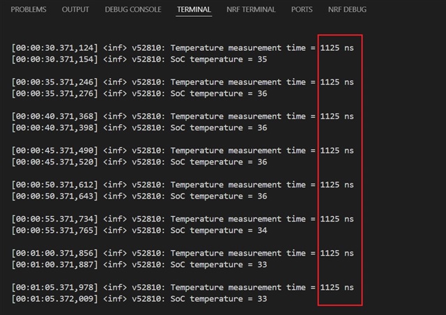

    Terminal output -->

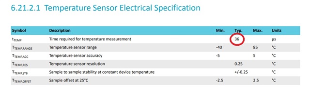

    As you can see the function returns 1125 nanoseconds (1.125 microseconds), although the documentation says that the temperature calculation time is about 36 microseconds.
    Can you please tell me where I'm making a mistake?
    Thank you.
    You are not clearing your events, and it seems that you're also not dereferencing TEMP_EVENTS_DATARDY. The data types are returned as 64 bit length, so you need to print as "%lld" types.

    This will print approx. 35 us:
    Temperature measurement time = 35437 ns
